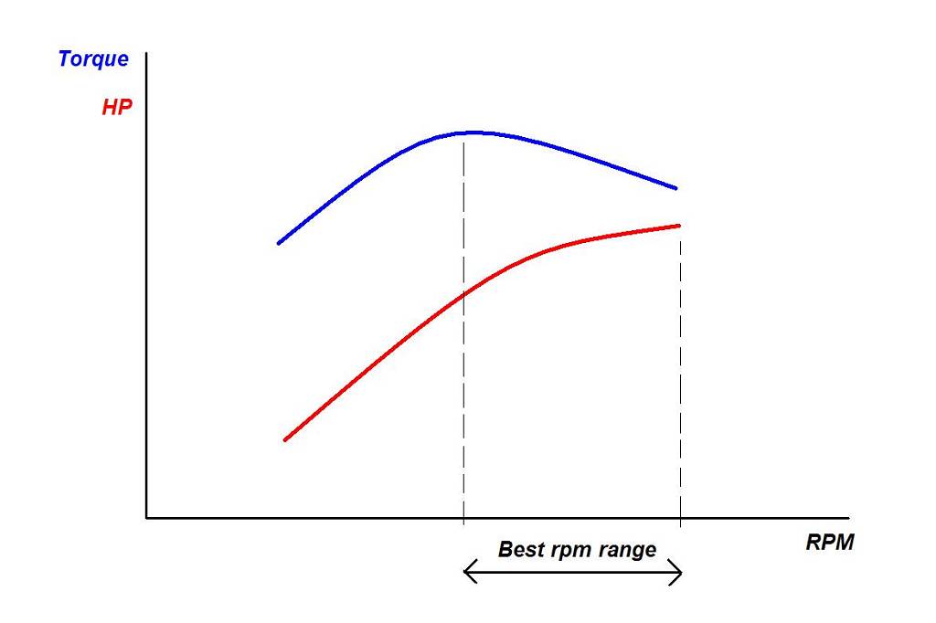

I agree with Jaka.
Each propeller is to a glow engine, as each gear is to the engine of your car.
There is a range of rpms, at which that glow engine is happy and it can handle that propeller efficiently.
That range is between rpms for max torque and rpms for max power output.
Rpms for max torque are always slower than rpms for max power output.
For level flight, the engine-prop can be swinging at max rpms (rpms for max power output), but, if you start a stepped or vertical climb, the AOA of the blades change and they demand more torque from the engine shaft.
Automatically, the engine looks for more torque by reducing the rpms to the max torque rpms (which improves the breathing of the engine).
If you want to fly your model efficiently beyond that range for that particular prop-engine combination, you need to modify that combo.
It is easier to switch props than engines; hence, you determine the pitch x rpm that will produce the horizontal flying speed that you expect.
Then, the new diameter is determined by the muscle of your engine (torque) at those rpms.
The max power given by an engine is constant, and it is used to move a volume of air at certain velocity.
Diameter and rpms of each prop determine the volume of air (volume changes with the square of the diameter).
Pitch and rpms or each prop determine the velocity of the air (velocity changes linearly with the pitch).
(Edited to add schematic)

Testing will tell. If the engine cant turn the prop fast enough to get up to the power range it will fall flat on its face quickly. 2 strokes are very "rpm dependent" in making good power.

Hehe now you're getting into the weeds! But if you want to go there......
For many uses it may not matter. If you're flying precision aerobatics, 3D you can get into some pretty serious tuning with prop choice.
Some props like APC, will out perform the same size wooden Zinger prop because the airfoils are more efficent or smoother. You might be able to get the same RPM on a 10x7 APC as a 10X6 cheapie wood prop (for example) or more rpm just by sticking with same size.
So to say you "have" to fly a Scimitar prop is hogwash. Though for some uses they may be a better choice. Personally I hate the things, they are too heavy and don't spin up fast enough for me, I use Xoar or Vess props. But the style of flying I do demands better response to throttle than I can get with a Top Flite prop.
3 or 4 blade props load the engine more so if you have a 10x6 2 blade you'd probably have to step down to 9x6 3 blade. A 4 blade would be worse. Now if you stuck that on the front of a Corsair as you used for your example, the prop tips would barely clear the cowl unless you have an oversize engine on it.
If you look at the big time scale guys they have pretty multi blade props for static judging and 2 blade props for the flight rounds. (yes not all of them but a high percentage)
So basically it really boils down to personal preference on how you want your plane to perform.. and the only way to figure that out is to experiment with different prop/engine combos... sound right?
