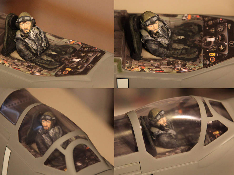

If anybody is interested, I created a nice custom cockpit graphic for my Spit. I posted it up in the RCGroups forum in the Spit thread. Feel free to print it out on your color printer, cut it out, and glue it into your cockpit.
Here's the thread & a pic. It's post #100
http://www.rcgroups.com/forums/showt...1142963&page=7
