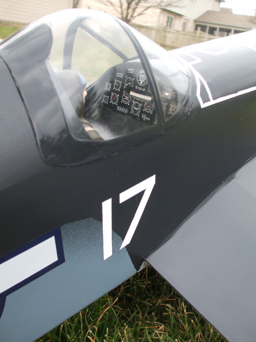

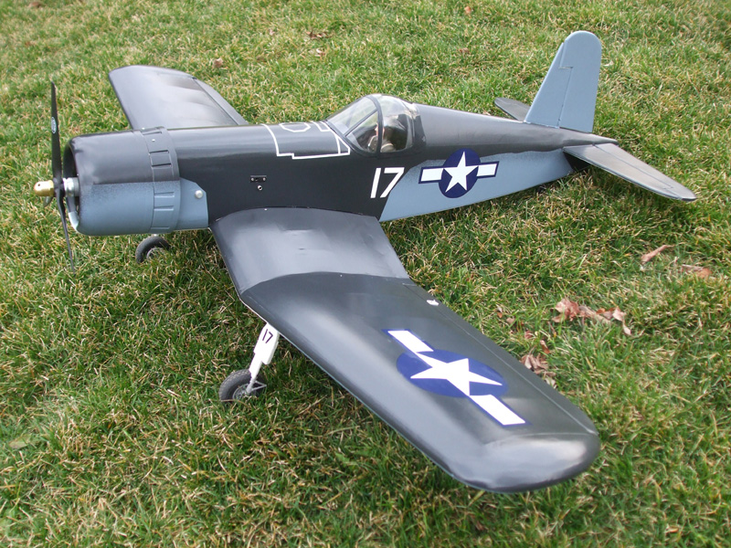

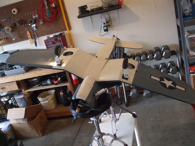

Well It's done. She's ready to fly. I hope flies half as well as she looks. I'm concerned about weight. She's coming in at 8.2 lbs. with a Magnum .70 up front and I had to add 7 ounces to the nose to balance her. I have retracts which added to this weight issue. I have well over 200 hours in this thing and want her to fly so badly! I can handle "enough" power to shoot holes in the sky. I don't want to do unlimited vertical or crazy aerobatics just putter around and look good. I have other planes for that sort of stuff. Am I in trouble with this weight and engine combo? Aside from putting a .91 FS in it, what else can I do except go full throttle and take off?! My stallspeed is going to be decrease a bit correct? Enjoy the pics!

ORIGINAL: capt17
The heavier your plane is, the higher the stalling speed in level flight.
The good side is that your model won't be affected as much by gusts of wind.
It's looking good.
Take it easy on the maiden, make sure you accelerate with a low nose attitude before hauling any steep turns!
