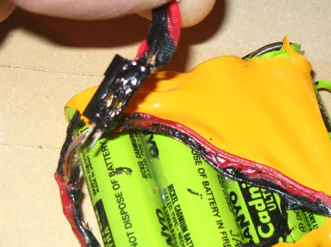

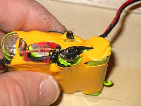

I agree with StevenMax, that you probably plugged in the battery backwards. I've done it too. In my case the battery pack was destroyed by the current and the pins on the RX circuit board were unsoldered, but the servos weren't damaged and the Rx was still usable, just had to plug the battery in to an empty channel. I would inspect the battery pack very carefully before charging it and it it's ok, test it before flying. If you replace the servo, hang onto it, you may need parts later.

I know I do not have alot of experiance at this. So when I read the posting about the possible servo problem I grew concerned that maybe I was wrong. All I can say is after reversing the connection, I had no problems all season long. I made many flights with that a/c and did nothing to the servos. I checked tham out last night and they still appear to be functioning normally.

Once upon a time, plugging in the battery backwards wouldn't kill anything.
The +ve is usually the centre lead, so plugging it in backwards just means that battery negative is applied to the receiver decoder signal output, not normally damaging. Plugging the battery direct into the servo would just apply battery -ve direct to the servo signal input, again not normally damaging.
To cause wires to catch fire and plugs to melt requires amps and amps, so either there's a reverse protection device crowbarring the battery or it's the servo mosfets that have reverse conducted somehow. In the second case, fiddling with the pot isn't going to do anything. One should be able to get the servo to move a little by waggling the sticks even with a squirrelly pot. So my guess is that the FETs are friedor there is a fault in the servo signal path.
Of course, if you have a connection system where the +ve and -ve are on the outside wires of a 3-wire system, and a connector that can be reversed then that's a fire just waiting to happen!

On the Futaba connector the pos lead is in the center, so when I inserted it backwards (it was an aftermarket pack with a Universal connector), The pos lead was in the right place and the neg lead was on the signal pin. Apparently, this was pretty much a direct short. The pack smoked in just a few seconds.
