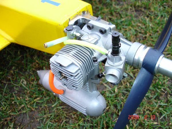

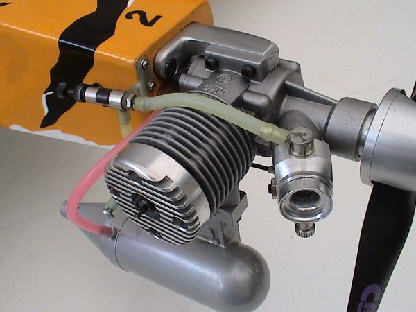

Default RE: Sideways or verical engine mount?
Hi!
Sideways of course!
Otherwise the carb will be too high!
