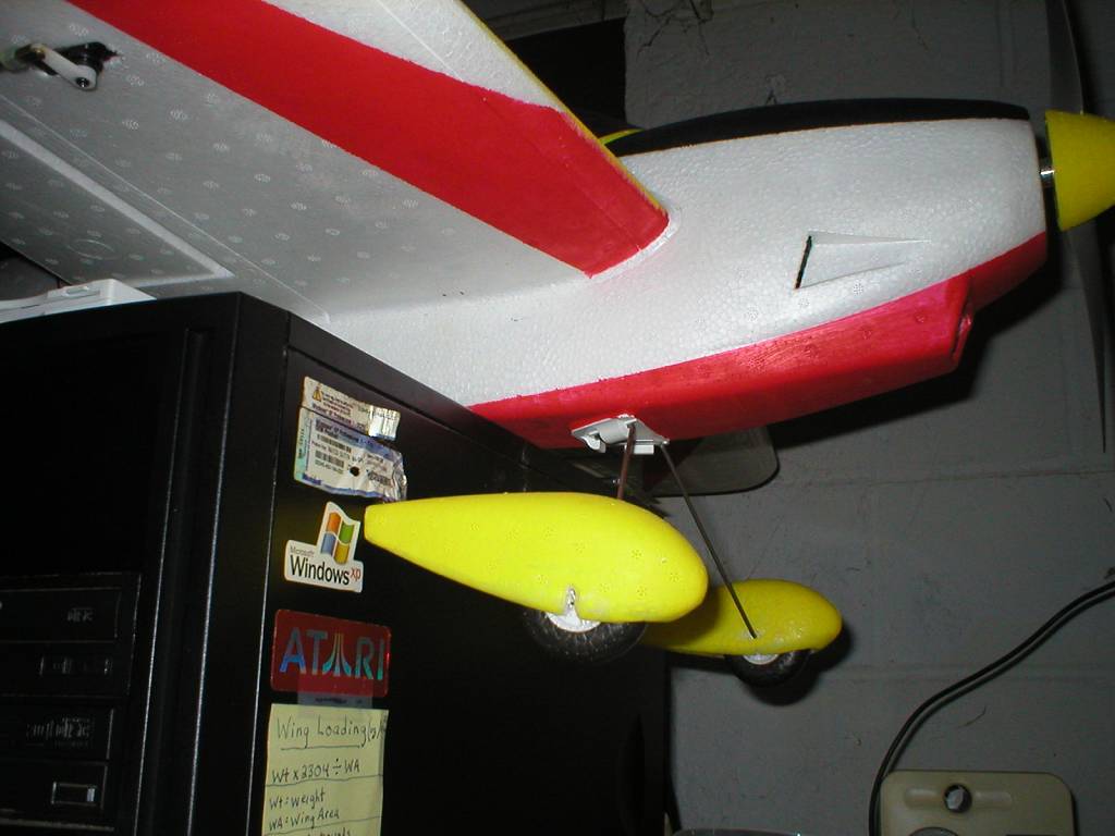

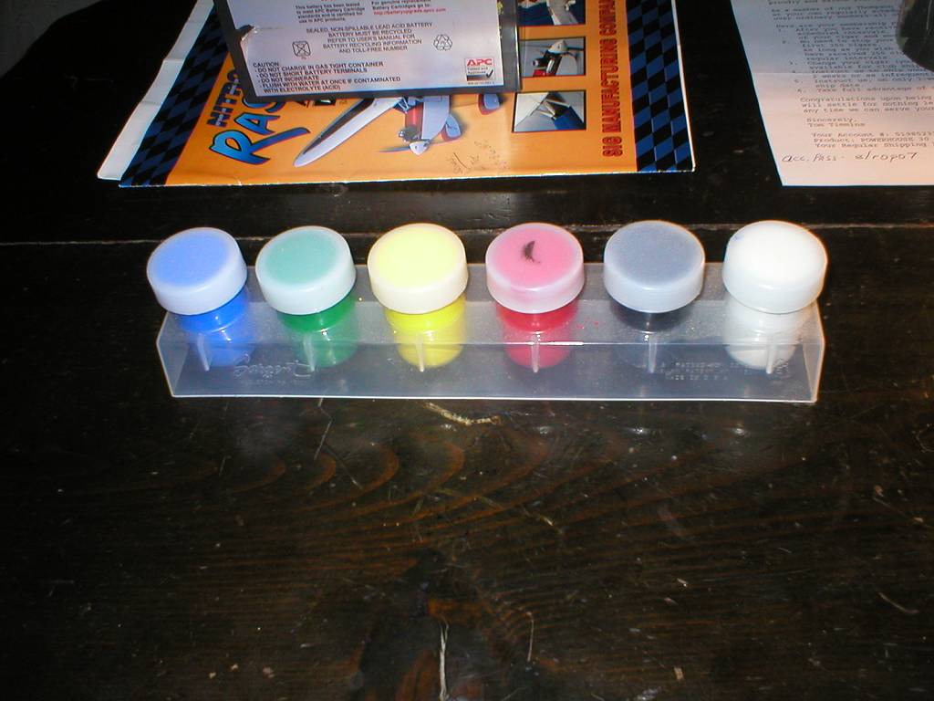

Poster Paints work well. Brush on as you wish, water clean-up.

Thanks for another option. Do you have to thin it? and how does it cover? multiple coats?

The planes I highlighted were able to handle the added weight , which was very little in total. I did not thin the paint, but you most certainly could try thinning and see how well it covers. These paints are extremely bright and do help quite a bit with orientation, speaking about my own eyes of course.
