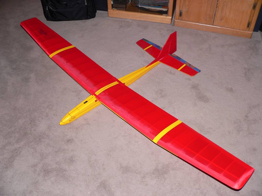

I have just put in my first flights on my JR8103 converted to 2.4. The question is how is the buddy box ( or cord ) set up different? Or is it just the same? I would think that since the signal is being transmitted thru the Master TX and that is on 2.4 that I should not have any problems. But I thought I would ask before I did it. Thanks.

Thanks for the conformation. But to check throttle is sort of hard to do. It's a sailplane. But I understand about matching the settings. I wanted to try the 2.4 on an easy set up before going on to my big birds. The buddy system was just a thought that came to mind. Again, thanks.
