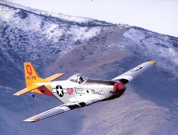

first I am surprised you found a Marie there on the chopping block for discontinued planes.
if you want to read about the blue nosed P-51 here is 39 pages http://www.rcuniverse.com/forum/m_8623566/tm.htm
for the marie go to the warbirds section, there are several long posts about it.
the 2 planes are night and day apart, the marie is a 8.5lb plane with open bay wings,the retracts are light weight and although servicable, many like myself have chosen to replace them with upgrades and struts.
the blue nose is more like 11lbs, and has fully sheeted wings and a heavier set of upgraded retracts, foiled control surfaces similar to the Top Flight ARF/kit, I will let you do some reading for yourself.
I should preface this by saying the Marie is one of my favorite planes, it flys like a sport plane and floats in for landings, its a good starter warbird with retracts and is just a cool looking plane in general.
now for engines, mine is powered by a OS 91 surpass 4stroke, and has plenty of power to do just about any manuver I need it to do,there is no need to over power this plane it is very light, anything over a 120/125 4stroke and its waisted power, and really dangerous, since without some major strengthening it will rip its self apart,there are many posts about weak firewalls and the flat tail feathers failing when overpowering this plane.
I would recomend using a 4stroke since they hide well in the cowl, run inverted with little to no adjustment sound better in a warbird IMO,and in the case of OS have very little oil residue even after a full days flying.
if your going to run a 2 stroke they are a little more fussy when inverted and require the tank to be positioned just right for reliable running.
mounting it sideways isn't the worst thing for numerous reasons, using a pits style muffler, but your going to have a head sticking out of the cowl but not a big muffler hanging out the side something I can't stand on my planes.
the 75AX would be a good choice for a 2st, or a 91 maximum for the Marie, the 120AX is really over the top unless your working the model over for speed, because thats what your going to get, as well as needing to cut the cowl up quite a bit for cooling and clearance.
these are just my opinions of course here's mine

Thanks bigtim,
My LHS had it sitting on the shelf for a while now said they don't make them any more so I had to get it. lol
I really do not want to chop the cowl up so it sounds like I need to go with a 4 s. An OS 91 surpass 4stroke would be great! Just have to save some more pennies.
I have been reading about the Robart struts, wheel mods and flap mods and they're on my to do list.
Thanks for the pics. Do you know how long the Marie has been around?

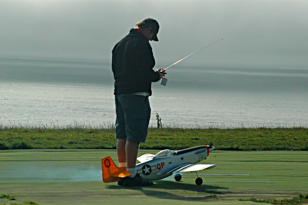

bigtim is that the stock exhaust showing in the first pic?

ORIGINAL: drube
its a early surpass silencer on a newer engine, the pipe is new just the silencer is the older style.
I had a older engine and I wanted the shorter pipe, when I sold the older one I shipped off the longer new one to the buyer, here is the regular pipe http://www3.towerhobbies.com/cgi-bin...?&I=LXCP62&P=Z its just a little longer than the older version.
