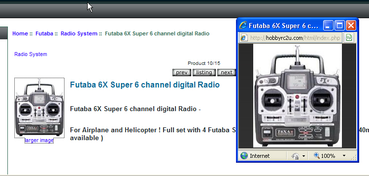

<span style="font-family: Arial; "><span style="font-size: larger; ">Hey, fellowhobbyists! I just got a new plane and it came with a6XAS pcm/ppm Super Radio System by Futaba. It is a 6 channel radio. I recently set this plane up for flapperons, butin orderfor them to work them, I need the channel 6 switch, which I cannot find out how to work! The channel 6 knob will not work, even though the manual mentions it several times for many functions. Just in case there is confusion, the radio i am using (since there are several versions of the 6x super) can be found HERE. Does anyone else have this problem? How do you fix it?

Channel 5 is the switch for retracts and channel 6 is the knob for flaps..you may need 4 servos for flapperons and or a y harness..There can be any number of factors ...you just have to read about,, could be that flaps wont come on until throttle is down under %25...?.Rog

The copy/paste from the manual is for the transmitter in the picture below.

Channel 6 is the knob on the top left side of the TX and yes it must be turned on in the programing to work.
The top right switch is the elev-flap mixing switch that will add flap to elevator. It has to be turned on in the programing to work also if you want it.
