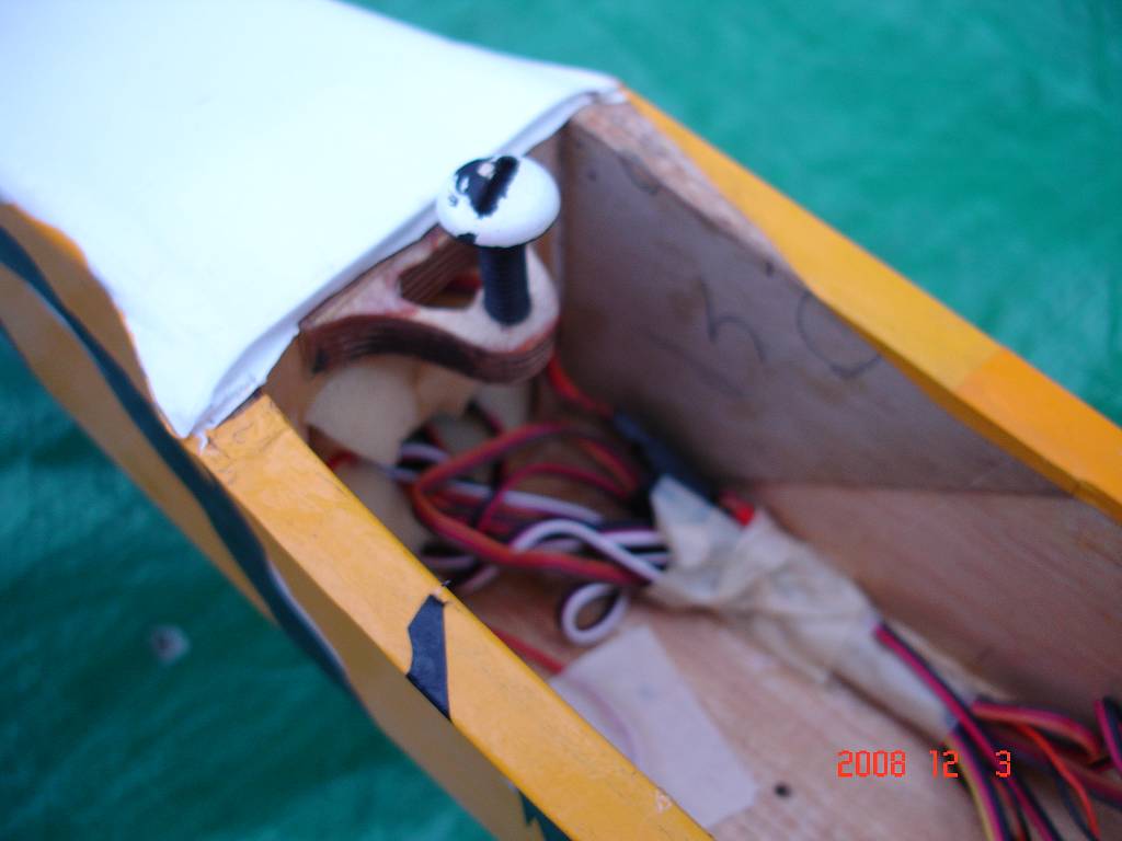

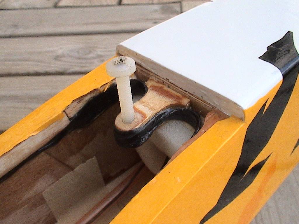

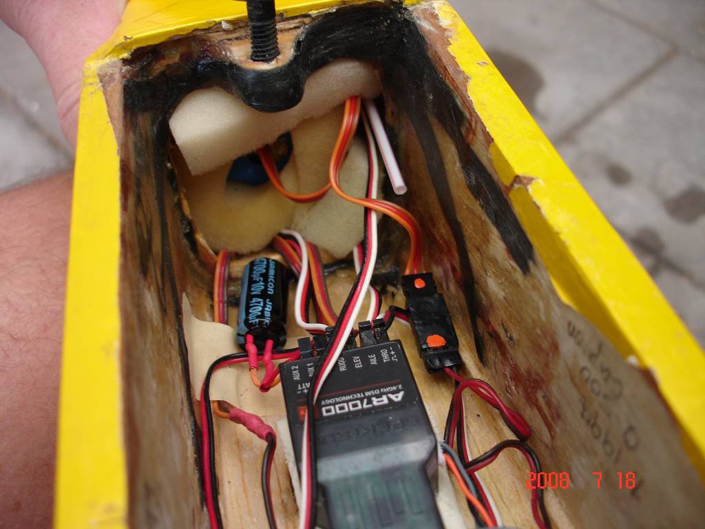

Hi!
I use threaded wood mounts in most of my Q-500 and Sport 40 racers (pylon racers) and other planes too. Much better than blind nuts and much easier to make.
