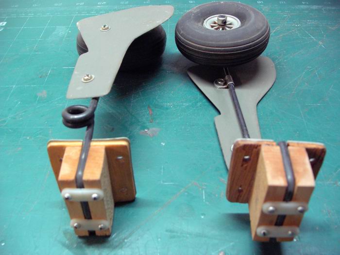

Gary here is a way to do what you requested but you will have to bend up the new gear yourself and make the blocks.
John
