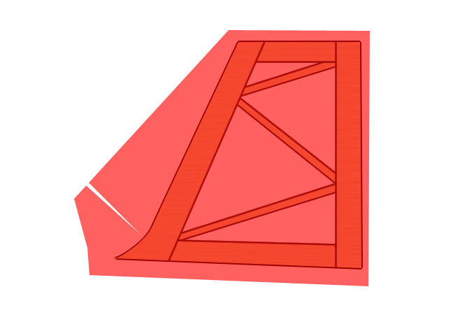

An inside curve is definitely tricky, but that's a small one, so it shouldn't be too difficult.
I would start by adding a 3/8" strip about 2" long to the front of the curve (Like you did on the seams). Then cover the fin as you normally would, but leave some extra in that curved area for pulling. Heat it as you pull it just as you would around any curve. If you need to, you can cut a slit at a 45 degree angle, but be careful that the split doesn't travel too much as you stretch

Try making another cut just above the curve so you can cover the straight section of th LE and do the curve separately

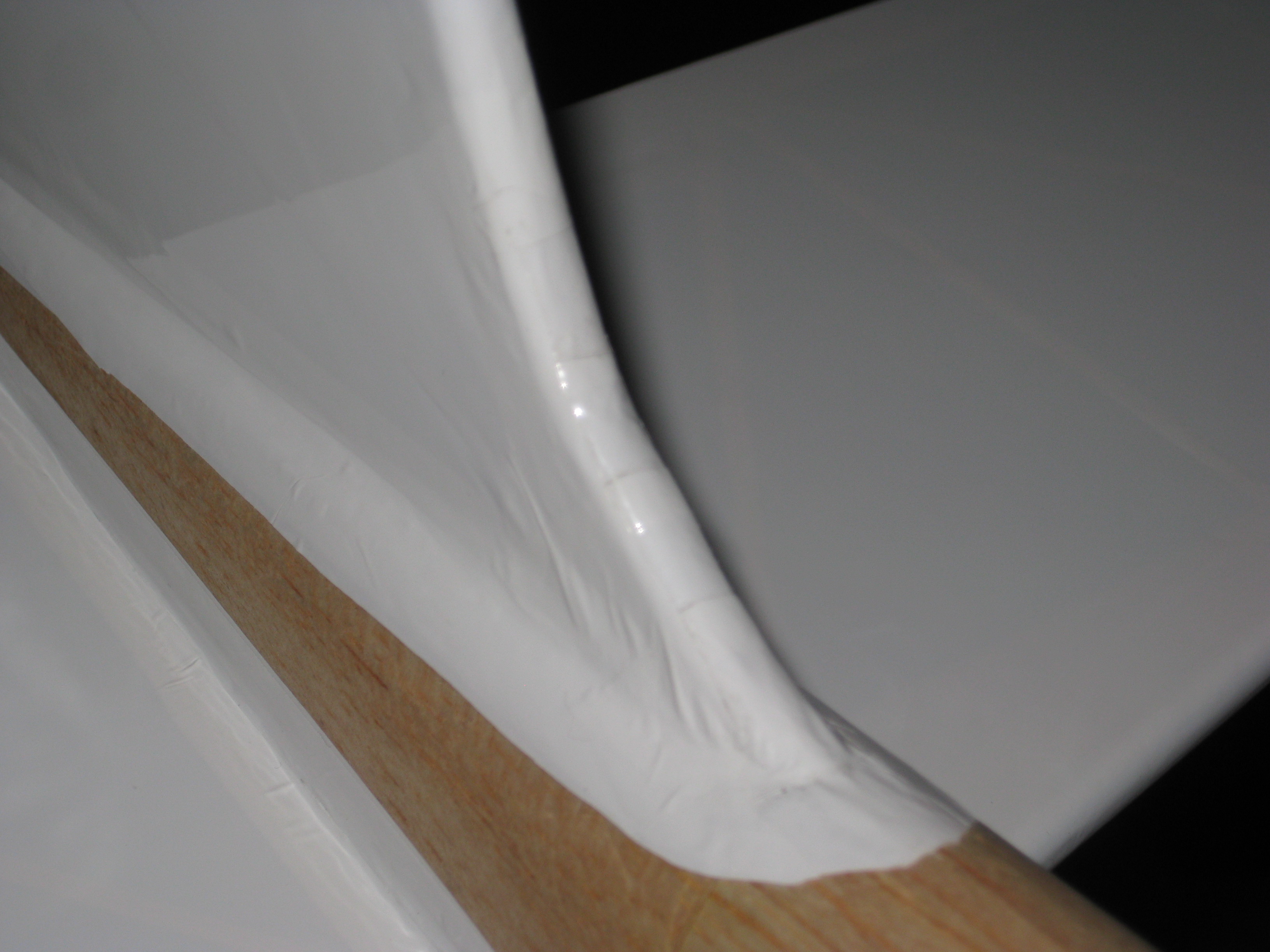

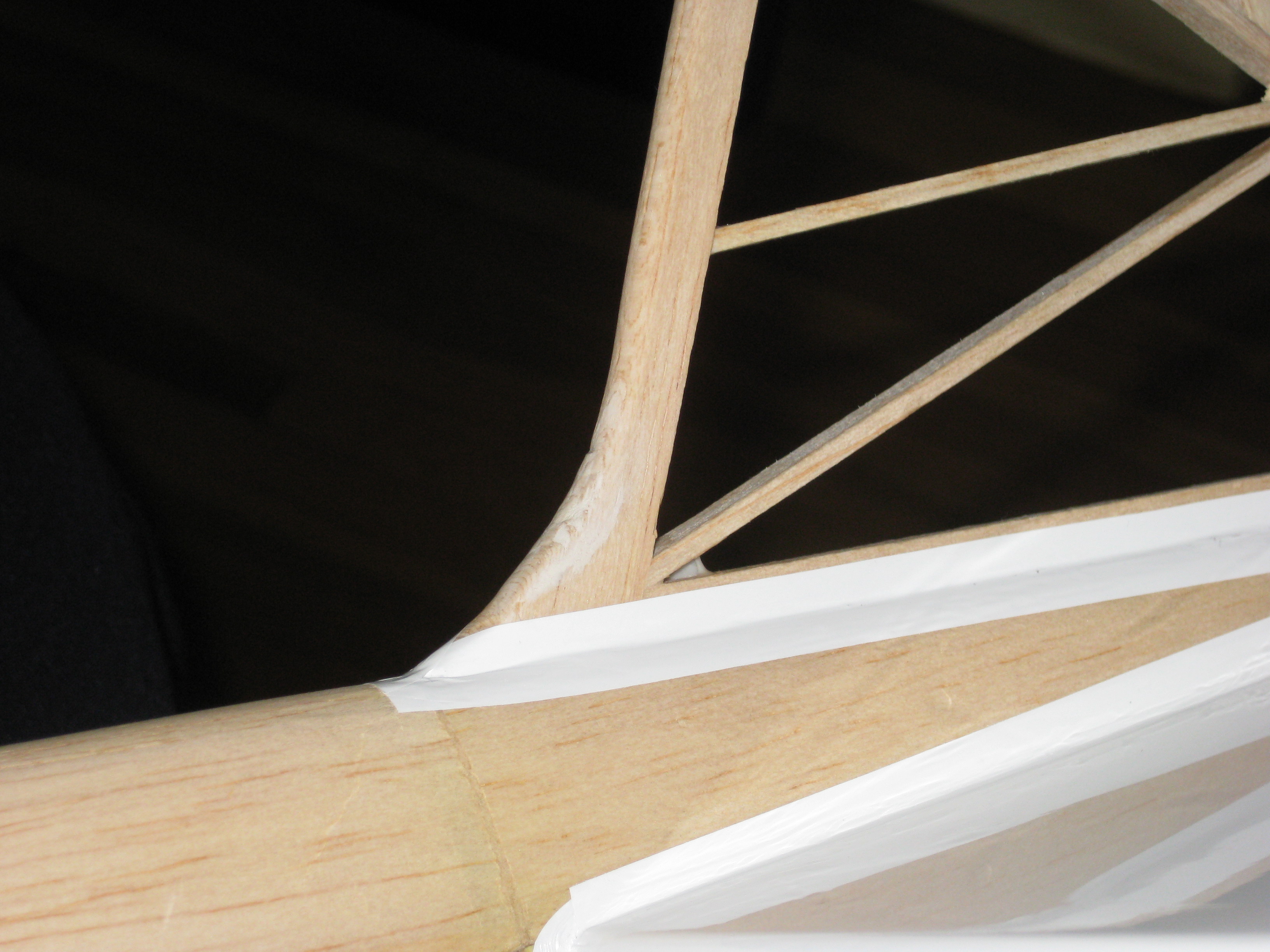

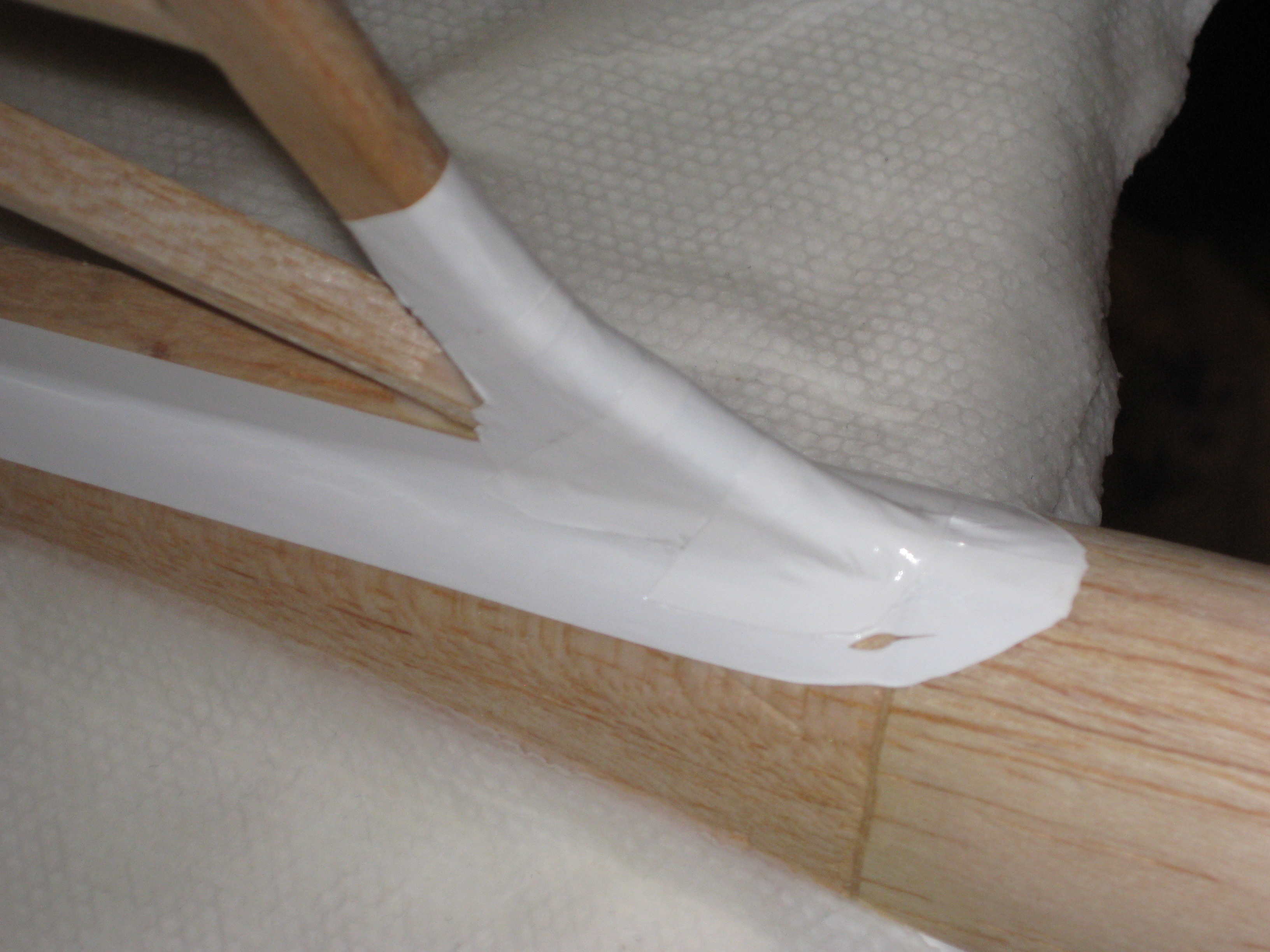

After 4 hours of trying...I couldnt get it, and this is what I wound up with. Its gonna have to do.

Old 04-21-2010 | 10:27 PM
opjose's Avatar
Joined: Nov 2005
Posts: 12,624
From: Poolesville, MD
Default RE: How to cover a curved verticle stab?
That's not bad.
When the plane is finished no one will notice.
You may want to trim a bit more of the excess away from the base ( fuselage ).
This will help you smooth it down a bit more, especially when you cover the fuse.

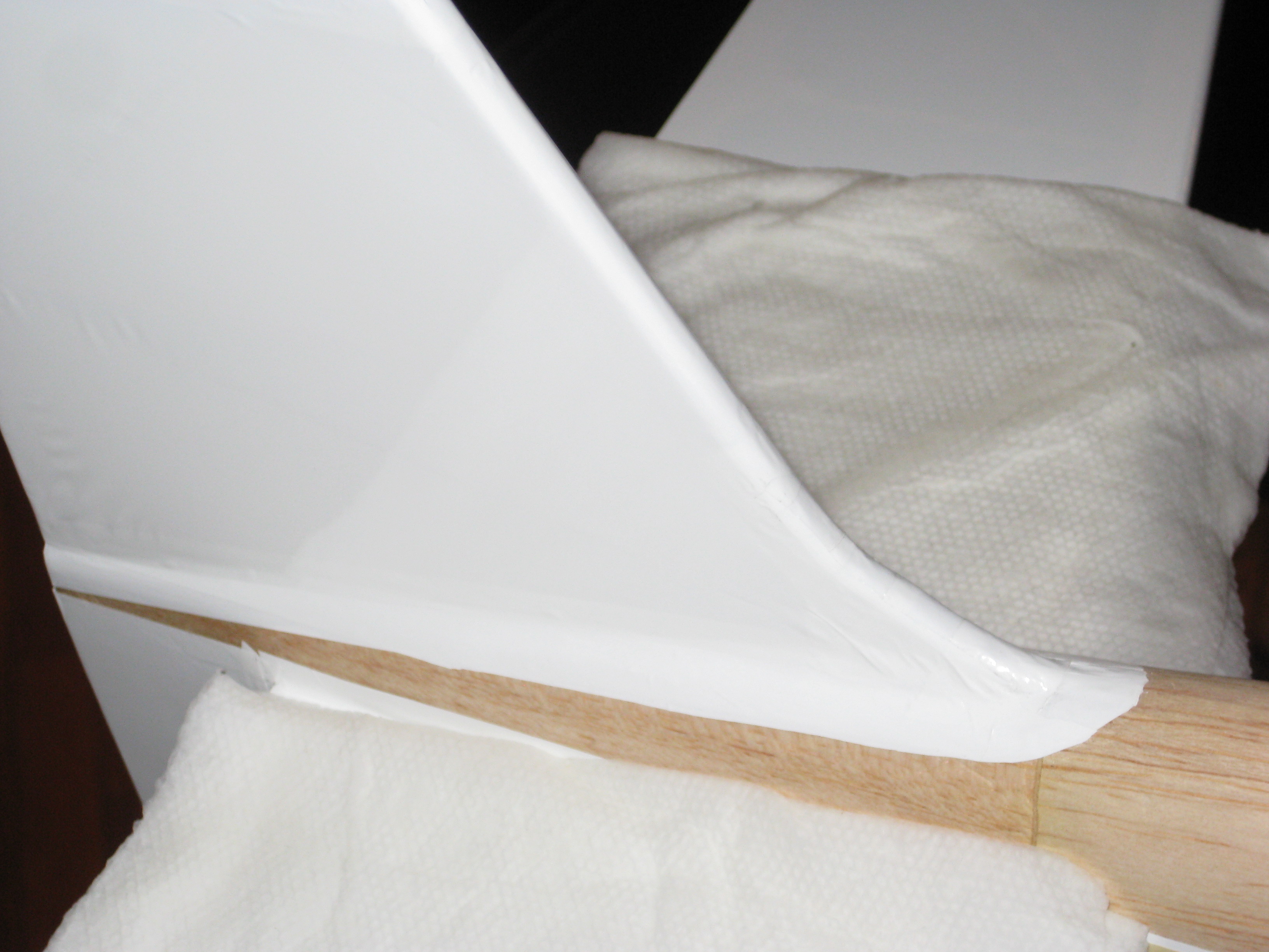

Thanks guys. Not perfect...but I think I can deal with it.
Now onto the wings!
Sometimes multiple slits help. Also you might try heating it up and use a soft cloth to GENTLY rub down the bumps. A pin hole in trapped air bumps helps too. the small TRIM monokote iron is a good tool for these kind of tight spots. I did notice your wrinkles or bumps are on the flat part.
Iron down all the flat parts first and sheild the area with cardboard or whatever then do the curve as you did before. this way the flat stays put, if its hot it can pullaway making wrinkles.
