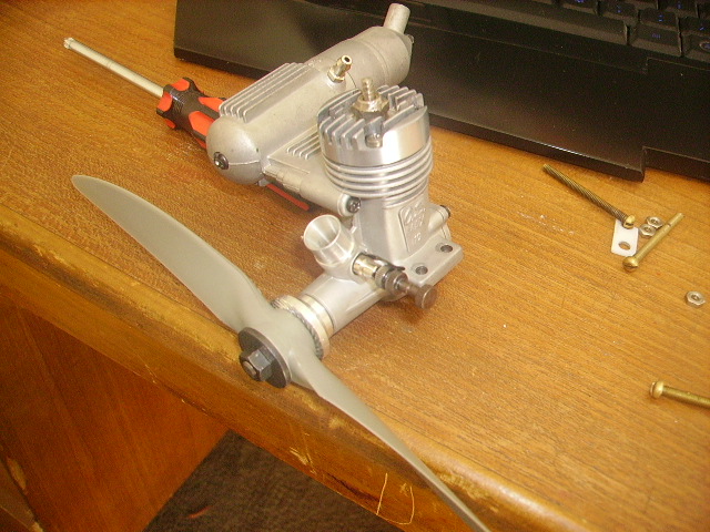

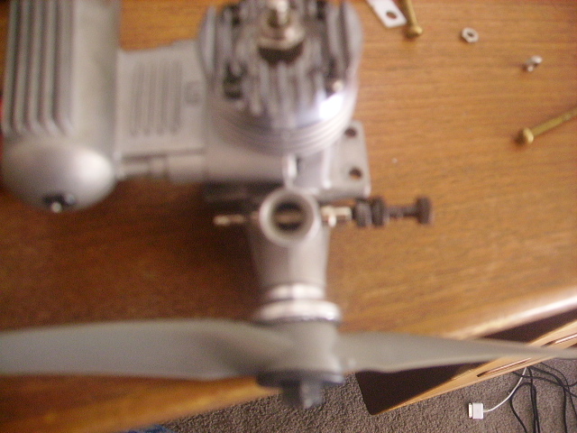

My friend gave me this O.S Max 10 engine that he found, i went and bought fuel, fuel lines, anew glowplug, 1.5volt battery and the sparkthingy that connects to the battery, but then i was wondering how do i control the speed, the is a mixture screw but no carb, i asked the guy at my local hobby store and he said it doent nee a carby, im making an airboat in my engineering class i have 2 servos but im wondering does it need a carb and how to i connect it to the servo? Any help would be appreciated!
P.S I put up two pictures of it

I could be wrong, but that thing appears to be a line control or free flight style engine, there isn't a throttle control on it. The barrel opening you see in the front with the needle valve is the carburetor.
Without serious modification (Different carb to start) you aren't going to get a throttle control on it.
Again, I could be wrong but that's how I see it.

You have a Control Line and/or Free Flight engine. Two speeds: Stop and Go. No Control. May I suggest you either trade it for one with a carb, or sell it on some auction and buy one with a carb. Good luck.

What you have is a control line (U-control for some of the older generation) engine.
It does not need a carburetor to run, but it will only run at one speed- wide open! this is not a huge deal, other that your airboat will move along at the fastest speed the engine will pull it, with no way to slow it down. To use this engine on your airboat, you'll only need one servo to operate the rudder.
As far as starting it, you'll need to connect two lines from the engine to the fuel tank- one from the carb to the fuel pick-up line on the tank and one from the muffler pressure tap to the vent line on the fuel tank.
After you've filled the tank, put your finger over the exhaust outlet on the muffler and flip the prop over several times (WITHOUT THE GLOW PLUG CLIP ON) quickly to prime the fuel system- you should see the fuel run through the pick-up fuel line to the venturi nipple.
Once the system has been primed, connect the glow plug clip to the glow plug and quickly flip the propeller counter-clockwise. Make sure to use a 'chicken stick' or electric starter, and be sure to stay out of the way of the prop!

Does that prop look like it's mounted backwards to anyone else? If you want it to be a "pusher" engine, (and I'm guessing you will for an airboat), you will have to get a reverse "pusher" prop. You can't just reverse the prop & run the engine backwards, even if it runs that way, it'll run poorly & try to self-loosen the propnut. I'd suggest finding an engine meant for rc use w/ throttle control and maybe finding someone at your LHS or local flying club to help show ya how to get it running & get the needles set for ya. Oh, and never stand in line with the prop while it's spinning! A blade letting go at 12,000 rpm can do serious bodily damage to ones bad self! Ask the one-eyed smiley->
Do a search here on RCU in the boat forums, I'm sure there's alot of guys building airboats there that have alot of valuable info for you to read up on.

Indeed it is a conventional prop mounted backwards, it is not a pusher prop.
