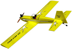

Sig Four-Star 120 / Kit
Wingspan 81 in (2057 mm)
Wing Area 1205 in² (78 dm²)
Weight 10 1/2 - 12 lb (4762 - 5443 g)
Wing Loading 20 - 22.9 oz/ft² (6103 - 6988 g/m²)
Length 65 in (1651 mm)
Radio Required 4-Channel with 5 servos
(2 aileron, 1 elevator, 1 rudder, 1 throtle)
Recommended Engines:
0.90 - 1.20 in³ (14.7 - 19.7 cm³) 2-Stroke
1.20 - 1.60 in³ (19.7 - 26.2 cm³) 4-Stroke
http://www.sigmfg.com/cgi-bin/dpsmar...FV4.html?E+Sig

How would that 4 Star 120 do with a 26cc gas engine?

It would be a perfect marriage.

It is an aerobatic trainer / sport model; hence, it is easier to fly than the Chipmunk, which a scale aerobatic.

A 26cc gas engine is a 1.56 and weighs a ton more than a 1.20 glow engine does....but it should work ok....Rog
