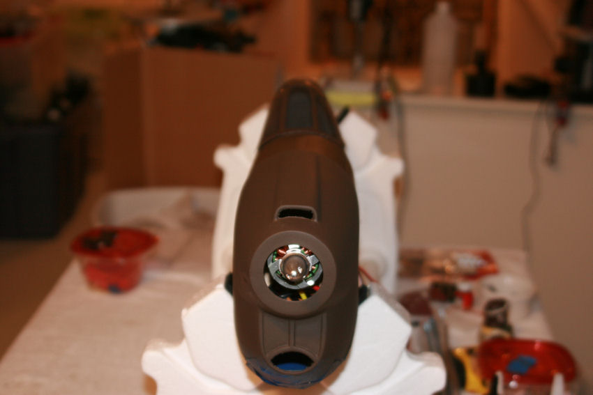

Just sprayed flat interior latex paint that was color matched to the Kyosho P-40 to correct the cowl which was shinny & way off color.
Used a cheapo airbrush powered by an air can. Took a few minutes & provided a great flat finish that is a excellent match to the flat skin of the plane. Cut the paint 75% paint 25% water for spraying.
