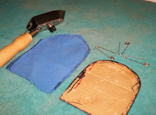

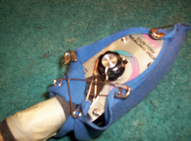

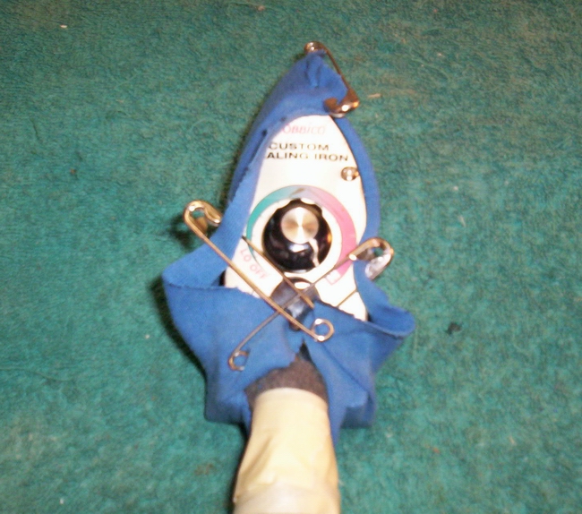

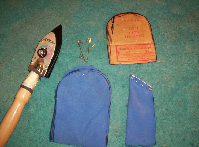

Default RE: How do you clean your covering iron?
I never have to clean my irons and I don,t have to go anyplace to get cotton baby socks and this method using my old cotton T shirts works great and surprisingly cotton/synthetics work fine too but just don,t last as long. Also using this setup you will find that the cotton does not walk around on the shoe like real baby socks do.
John
My apologies the posting program mixs up the order of the photos.
