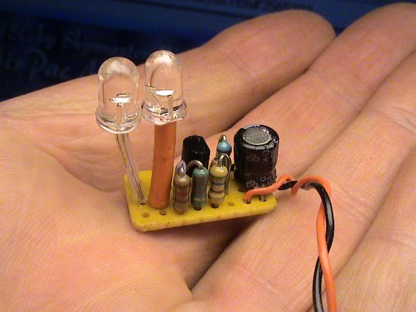

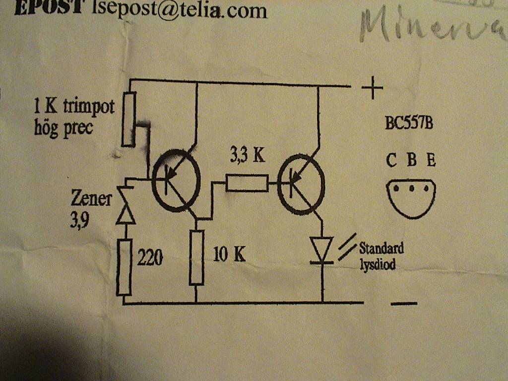

Hi!
Sounds strange that you loose programing from day to day????
4,8V is Ok as long as you the status of the battery pack (same for a 6v pack).
To check a battery pack you have get a "Multimeter" so you can check voltage under load. Just run 4-6 servos and as the same time check the voltage over each battery (you stick needles in the + and - poles)
A good way to always have some knowhow about the battery status in the plane is to use a "voltwatch"! I have one of those in every plane I have. Have been using them for the last 25 years.
