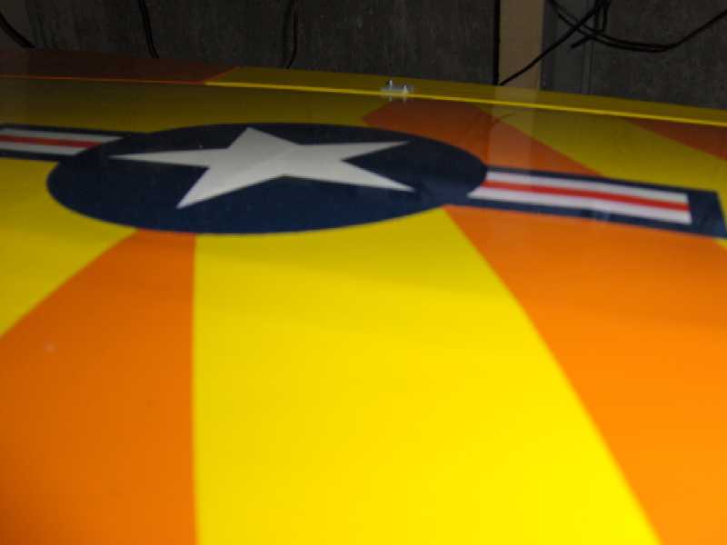

Spray the area first with Windex or even water with a little dish detergent and then squeege out the air bubbles with a Kleenex wrapped over a credit card.
Works with Vinyl over Monokote or with Monocote trim sheet over Monokote film.
