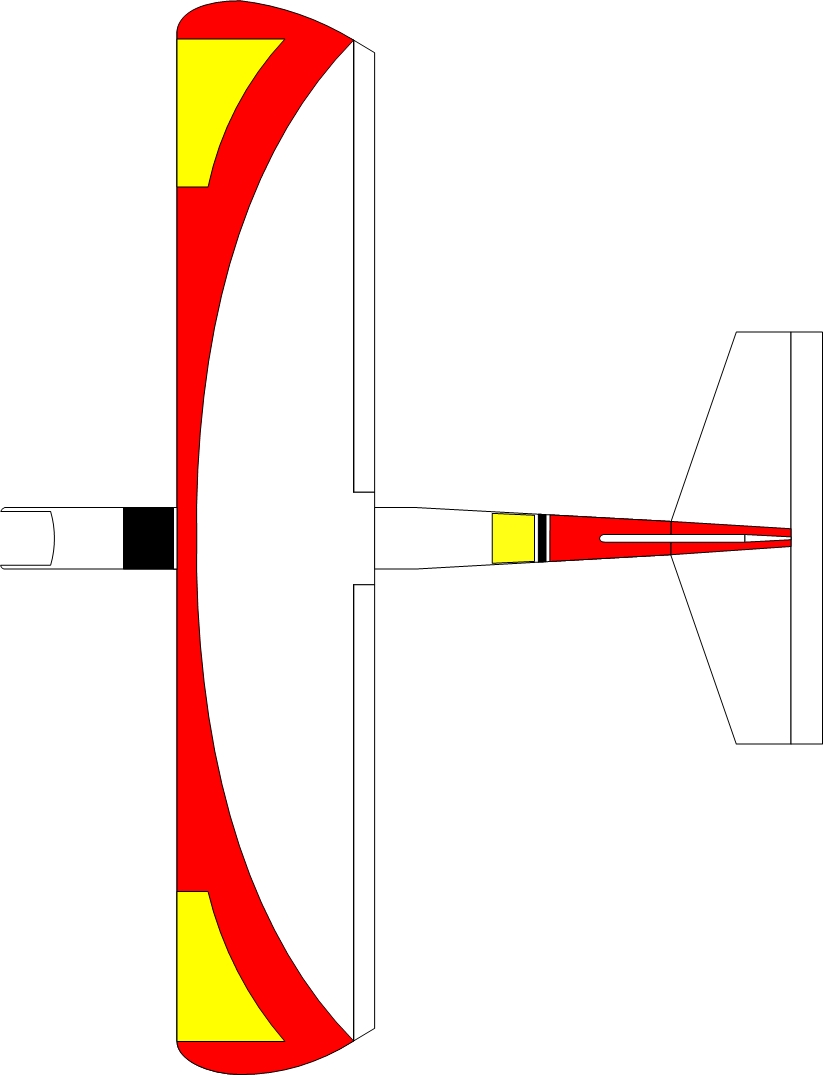

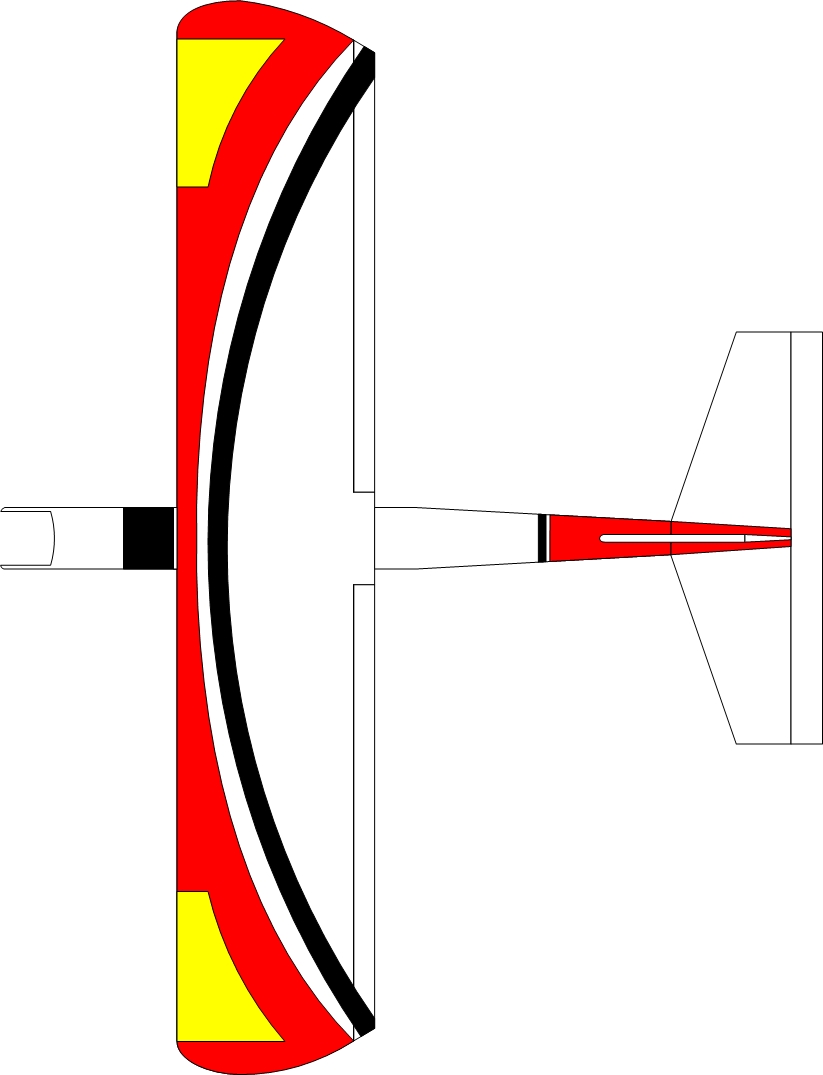

Im in the process of creating the scheme for the top of a Funtana X100. Ive cut a template of the design, however am unsure of the right color to use.
I can use silver, but because of the glossy, reflective nature of silver ultracote, I am wondering if this will pose a visibility issue due to reflected sunlight.
I was also considering using the transparent violet ultracote. The problem here is that the bottom of the wing is the same color, and wonder if it would get confusing when things got "interesting".
Any thoughts, experience or ideas would be appreciated.

Silver is great when it reflects sunlight but almost invisible on cloudy days or when it is between you and the sun. In the second image the wedge between the yellow and the black on the wings and rudder is silver. Looks gray against the gray sky. It's as bad as light blue. Put wide contrasting stripes on the underside of the wings and something totally different on the top. The Contender is featureless orange underneath (hard to see in that view, but the wing tips are black on top) and the Hot Stik is fluorescent green with orange stripes (give you a seizure viewed up close).
Yellow, orange, chartreuse, black and good 'ol red show up well. Contrast darks vs. lights on opposite surfaces. Looking up through a semi-transparent covering that's on both sides of a wing isn't so good.

Do you guys agree with Charlie in that using the Silver on top for the pattern is a bad idea? I totally understand what he is saying and seems to make sense...but just wanted another opinion.

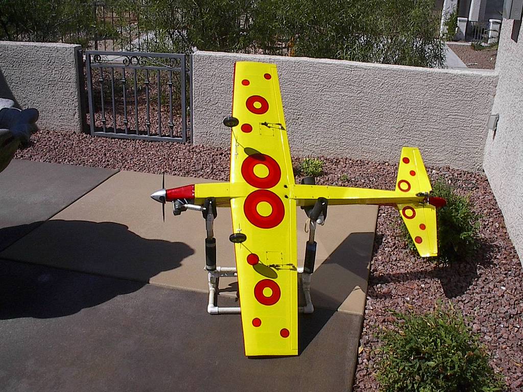

Being color blind when I do one of my own planes I will be sure to use yellow, I can see that pretty well but as long as I have very contrasting colors I'm OK. I have always used contrasting stripes on the bottom but one day I gave this a shot. Everyone at the field was impressed with how well it stood out even in overcast conditions. I did it just for fun but it really did work out well.

Lime green it is then. Thank you guys!

Looking at the pics of your original post the bottom silver feathers over a blue / purple background, I tend to make the feathers bigger. Perhaps make the width of a feather the same as the width between two adjacent wing ribs.
The "tear" on the wing top would look great in red over yellow. Mind if I steal your idea????? You can build a film panel on a big chunk of glass and then apply the 1-piece panel to your wing. That way you don't have to dance with the "trim bubble" devil.

Fluorescent green is easy to see but not my favorite color. My young student spotted a nice plane at an IMAC and took a photo so he could make up a close copy for his own plane. This one was really easy to see!!!

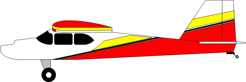

Some alternative schemes that differentiate between the bottom and top. These are a Bridi Killer Kaos 60, SSE and Hog Bipe. All 40/60 size models.

I like your design. What about clear on the LE design with dark blue where the two meet? It would look like the white was tearing off. Just a thought.

Great suggestion David. Ultracote clear is "lite" film and works very well for the LE (and for sealing hinges and the occasional errant weed hole).

I really like #2&3, can't decide what one I like best?? No way I would ever be able to keep up with number one though. I'm thinking I may do something like #2 on my next covering job. Thanks for the post!!!

Seamus - Thats a really great scheme. I really like the fuse. As mentioned earlier I decided to work with the Lime Green Ultracote. My LHS didnt have it in stock, but ordered it and she should have it tomorrow. It might be a while till I actually get to fly the plane since Ive been so busy with other things, but will certainly post pics of the wings as I make progress. I cant believe its almost July already and Ive only flown once so far . In the previous 3 years Im usually about 3 gallons in by now.
Came to the realization that it might have been easier to do the scheme im going for by laying the covering layers prior to covering the frame. I guess you learn as you go. Im still optimistic of getting a decent end result.
