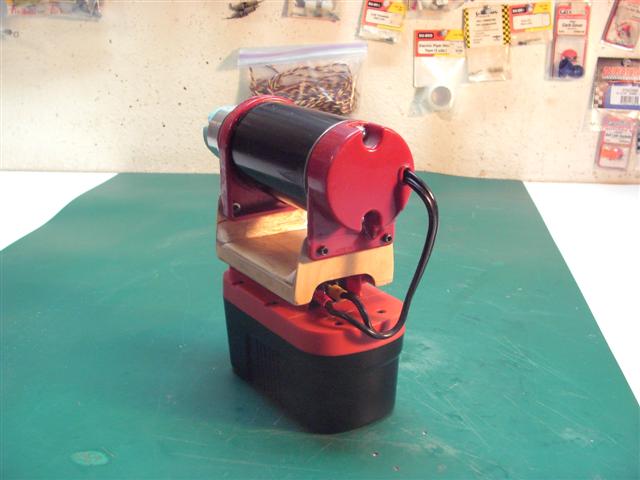

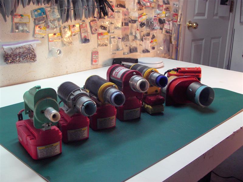

Here is the link to the Harbour freight battery that Grey beard has talked about. Originally when I first started to experiment with those, they were ten bucks and I made up six of those with various starters and even my Sullivan 1/2A starter. They work great.
http://www.harborfreight.com/18-volt-battery-67029.html
Last year I also completed my home made geared starter for the 120 Dynatron with a three inch cone to use with my larger ships and that I ended up powering with a 24 volt Black and Decker drill battery. With this I use a short cord on the starter and plug it straight to the pack. This pack unlike the cheapie packs has Sanyo Cells and is a Nicd. It consists of twenty cells and I ordered it from True Value hardware for sixty bucks.
This geared combination has proven awesome.
Now recently I got dragged kicking and screaming out of pylon retirement by some of the fellows and in particular one who I have been mentoring in some of the less common modeling venues.
Anyway I found my self needing a small but light weight starter agine that while used a small cone but was much higher speed than the typical types and even the previous 18 volt units I had done.
You see one may compete in just four rounds (races) over the day but when when the competitors go on the clock you have just ninety seconds to start the airplane and launch to be ready for a count down start. Everything in the starting procedure must be perfect and rehearsed or you are wasteing your time.
So what I decided to do was use a 90 amp Hobbico Torquemaster with the same 24 volt battery. I was not sure if the switch could handle the 24 volt battery and the likely loads that the starter could pull with it but to my surprise the switch has held up beautifully. This one I took a little more time and made a wooden frame that allows the same battery to be used with both the geared starter and this one using the sliding tray as is used on the drill. It was worth the effort since I discovered that this slide mount is almost identical to the Harbour Freight battery with the only differance being the lock mechanism but with a slight alteration both the 18 and 24 volt batteries are now interchangeable using the drill slider.
John
