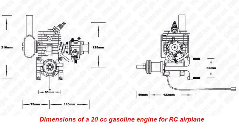

Are you sure it reads cc's after the 20?
The most common trainer has a 0.40 cubic inch glow engine (it uses nitro-methane as fuel).
Engines of 40 cc are fueled by gasoline and are big and heavy.
This site has plans for a 0.20~0.25 cubic inch and step by step with many pictures; however, it is in Spanish:
http://picayzumba.com/content-cat-6.html
I believe you will be able to bild it if you use a on-line translator:
http://www.altavista.com/

A 20 cc engine isn't small: that's over 1.2 cubic inches. I continue to think it likely that this is an OS .20 (i.e. .2 cubic inches). Is there some reason you won't tell us the approximate size of the engine, from the bottom of the crankcase to the top of the cylinder? That way we would have a good notion of what you have. Saying "it is small" tells us nothing; saying "it is small and it's 20 cc" makes no sense at all.

Read this article about a model that uses a 20 cc gasoline engine:
http://www.rcuniverse.com/magazine/a...rticle_id=1152
The plans you are looking for should be for a model of similar wing area and weight.
