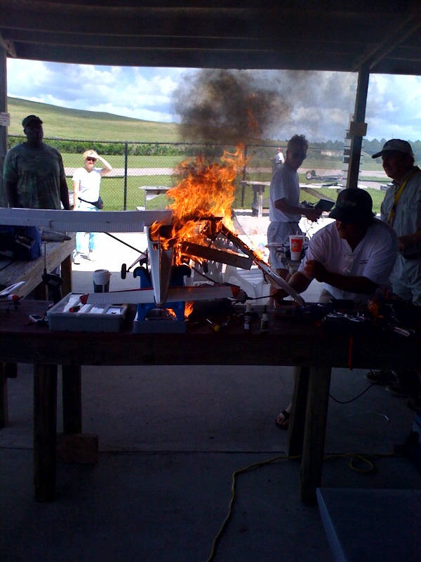

ORIGINAL: KWJ48
I agree with you on the LiFe packs, but he was asking about lipo. And any battery or component can fail at any given time.
AND........ are you going to remove the onboard pack evey time you charge it? I charge my onboard packs in the plane. Have you ever seen a plane burn to the ground due to a lipo fire? I have, darn near saw a grown man cry at the same time. I'll stick w/ NiMh and NiCad's thanks.
Rrragman

ORIGINAL: rrragmanliam
ORIGINAL: KWJ48
Rrragman
Yes... It's the same as any electric plane with lipos. No I have never personally seen any plane burn to the ground with any battery, but I know it can happen with any battery, all it takes is a short to let the smoke out. You ever see a car battery swell up and blow or melt wires and catch fire? It just takes a little more caution and knowledge with lipos. I have 6 planes that I currently fly on a regular basis. 3 are Electric and 3 are nitro. 2 of the nitros have lipos with regs. I charge all lipos in lipo bags.

These batteries can indeed catch fire. Check out the mfg web page & there "safety precautions "
Like anything else, the very rare negative incidents with the use of these batteries get the most attention. I'm sure if you looked at the number of those in use compared to the number of incidents like Lipos catching fire you would find an incredibly small number. Generally, if you charge/use/discharge and store them properly along with the use of a balancing charger you should have zero issues. I use 2S 7.4V Lipo Rx batts in 4 of my planes, 2 with digital servos, and have never had a problem. I charge them at the field once and can then fly any one of them all day without going below safe voltage.

Timcat 26
Thank's for the 411 on lipo care and feeding, I "get" it. They are safe as long as you do this, you don't do that, you watch out for this,be mindull of that, bla bla bla. The problem arises when the human factor or eqipment failure is inserted into the checklist. All lithium batteries will combust givin the right conditions. Does it happen often? No. Can and does it happen? Yes !

ORIGINAL: timcat26
I'vre also heard of cases of spontaneous human combustion. It doesn't stop me from occasionally being next to other humans. Get it now? [img][/img]
Differecnce is I've actualy seen a lipo fire. How many humans have you witnessed spontaneously combust?
