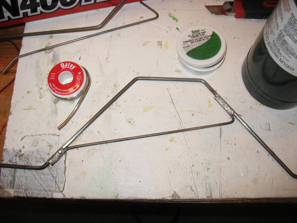

I was given a set of floats from a club member sans gear. I have bent 3/16" rod into the support structure and need to cross brace. I do not have access to a welding machine. I had read you can wrap the joint in copper wire and solder so I tried this but it failed.
First the propane torch oxides the copper quickly and so nothing will stick and the flux burnt quickly adding carbon to the mix so nothing would stick. There is too much mass for a solder gun. Also, should the copper wrap completely cover the steel underneath (so you are only soldering to copper)?
What is the correct procedure (step by step for idiots)?

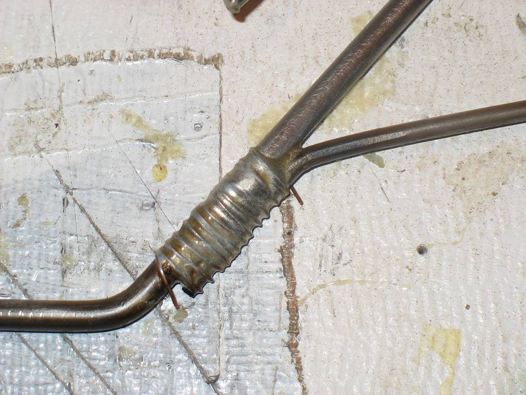

The trick must be the solder and/or the flux. For sure the solder melted at a much lower temperature than what I used before. I was able to indirectly heat the wire, have the flux melt and then boil, then hit it with solder and have everything flow nicely. The flux still did seem to burn but still allowed the solder to flow.
It won't win any beauty contests but seems to be strong.

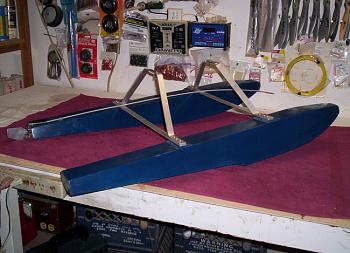

Yes to solder 5/32 or larger piano wire plain 60/40 or rosin core solder is extremely difficult. Its harder to find these days but acid core solder works very well.
Better yet these days, though all my floats I built the old way with wire but these days plain s.o. soft strap aluminum is so much easyier to make and looks so much better. Thats all I use these days for float struts.

If I may suggest: Trim off the wire ends sticking out then tap whatever nub remains down and away by placing the completed joint firmly against a solid object (like a vise, which act's as a "bucking" anvil) as you strike with a hammer. Coat your finished assembly with oil and wipe excess off. These type solder joints tend to rust up over time unless protected.

I cleaned with alcohol, but it was isopropyl so not much sense in drinking that. Sanded, cleaned, soldered; cleaned in soap and water and used file to trim the copper wire per suggestion above (post pic). I painted the metal but taped over the solder joints just in case they break and need to be re-soldered; would be impossible if painted.

If the flip-side of that finished solder joint looks like the front shown in your photo...That joint "ain't goin' nowhere"!
