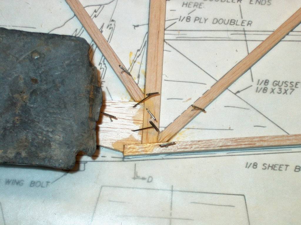

I`m in the process of building a Sig Seniorita,my first build in a long time.
I want to get the joints snug and secure,without the use of CA Glue,,I`m using Sig Bond just to try and build the plane "Old school"
Is there a problem if the glue runs from the joints,or gets "Gloppy"?
I do my best to clean up the joints with a scrap piece of balsa,but sometimes it is still "Thick"
I`m trying to get it as strong as I can with no gaps for a nice build.

as long as the glue is not running into any important areas like where the ailerons are I would not worry about it.. you will not overload the plane with glue trust me I have rebuilt trainers many times and some of them are more e-poxxy than balsa and they still fly great so.. use your best jugment and you will be fine

Anything that shows outside of the joint seam is too much. I like aliphatic glues - if you keep a damp rag and a little dish of water you can wipe off all the excess. Just make sure ypu keep it well pinned or weighed down to a flat surface so it won't warp as it dries.

Another trick is to use a resin brush and apply the glue with that. Rise it off in warm water and it will last indefinately. It's a lot easier to control the dose than a glue bottle nozzle. It is also great to pull excess glue off the wood and corners around a joint
I helped an Explorer post build four LT-40's with Titebond II. Of the four teams, one used 1/2 of a bottle. One used TWO BOTTLES. The other two teams each had some left from one bottle.
All flew fine.
But, as a rule of thumb, lighter flies better. Just enough of anything is the goal in airplanes - models or the real thing.

All of the above advice is right on the money. Plus you sound like you are on the right track trying to keep extra glue off the plane structure. That will help a lot. If you miss a drop or two don't get wrapped around an axle because of it. Glues like alphatic and white glue lose a lot of weight as they dry, so a little bit of extra here and there isn't going to be a plane killer.

Good choice of trainer by the way. The strength will be in the accuracy of the joint. Glue works better when the wood is in contact with wood. Gap filling is to be avoided. It is a matter of degees though. My joints are not always perfect but I keep trying to get nicer fits with every build. A little bit of filet in the lesser angles is ok too.
