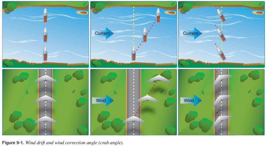

It would help for some to review basic vector concepts also.
A picture is worth a thousand words.

Interesting that the graphic illustrates the boat analogy. Although as a FS pilot, I learned about crab angle, and wind drift in my Taylorcraft years ago. I have NO illusions about which way an airplane will move in a "wind" (a.k.a. "moving air mass") and how vitally-important the rudder is to getting where one intends to go.
Thx, Rob
