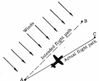

Since the discussion has led to vector calculations and you understand compass directions… try this link.
http://www.csgnetwork.com/e6bcalc.html
It is an online version of an e6b calculator - it does the vector calculations for you.
Two examples. (with diagrams to illustrate the difference)
Example 1 - use box 4 in the calculator (Course, Ground Speed and wind correction angle)
Your aircraft is flying north (0 degrees) at 30 Mph - Vector 1
Wind is from the west, 270 degrees at 10 Mph - Vector 2
Combine these vectors you get the resultant, a ground track of 18 degrees at a speed of 32 Mph.
IE the westerly wind has moved your course over the ground to the right (right drift)
http://www.rcuniverse.com/forum/atta...mentid=1975514

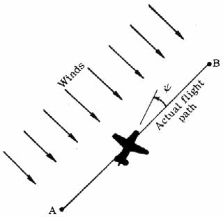

Example 2 - use box 3 in the calculator (Heading, Ground speed and Wind correction angle)
Wind is from 270 again at 10 mph.
But this time you want to fly a Ground track of 0 (due north)
Your aircraft airspeed is 30 Mph.
The calculator computes a heading of 341 degrees. IE when you aircraft is pointing at 341, it will be moving across the ground in the direction of North (0 degrees)
http://www.rcuniverse.com/forum/atta...mentid=1975515
At no stage do you need to hold rudder to compensate for the cross wind. The vector of your aircraft flight path will do that once you have the correct heading.
Its all done by eyeball with RC aircraft but when you understand the theory behind it, it makes more sense.
Credit to NASA again for the diagrams.
