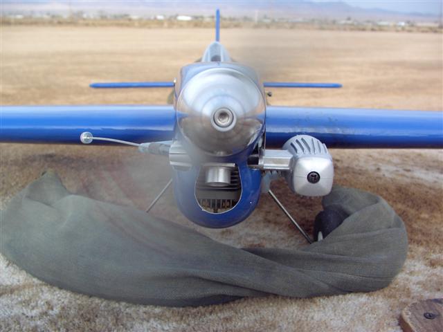

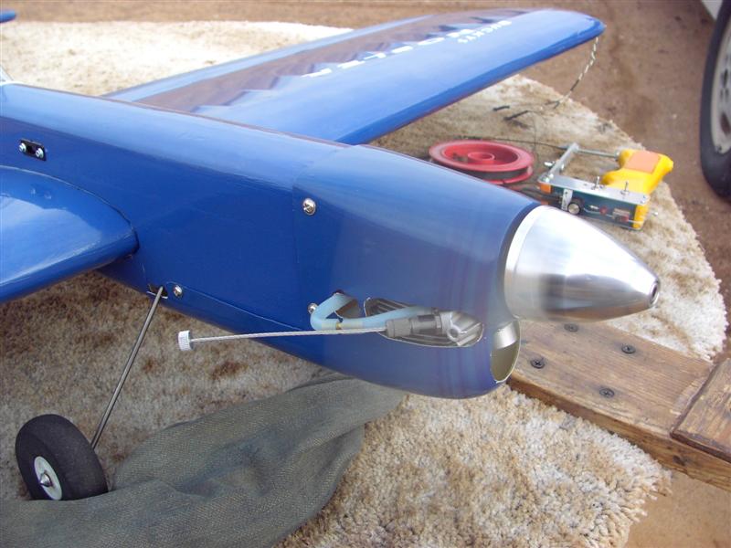

I just wanted to note that all the AX's come with a three inch length of flex cable that inserts into the needle valve to provide an extension and without the problems noted by Jaka. Even has a nice thumb wheel for the other end. I find this very nice and I normally leave them full length on all my AX's and I have a bunch. This is especially appreciated on some of my multi engine airplanes.
The pictures above are a .35 AX engine.

Ah!!! Vibration. Never thought of vibration and the rubber hose. I did hold the hose straight during the engine run so vibration should have been minimal. Still have to think about these things. I did balance the prop. It is something I did not do when I used to fly. Learned about it here. Lots to learn on this forum. Thanks.
John, thanks for posting the photos. My engine did come with the needle valve extension. I thought it was for airplanes with engine cowls. I will install it and give it a try. My old OS had a straight needle valve bringing you close to the prop. This engine has the angled needle valve which is better. The extension will make it much better and safer. Thanks.

OzMo 01-10-2015 11:28 AM
the included extension has low mass so does not cause problems compared to a heavy tube. Use locktight on those set screws!
Because little brass knobs are hard to find in the grass...don't ask how I know!:rolleyes:
JohnBuckner 01-10-2015 12:15 PM
Regarding the set screws ET on the OS included extensions do remember the set screw is a metric size both in the needle valve and the included knurled thumb wheel and its quite small I cannot off hand the size, remember these won't work if you use the wrong tool .
I think I have around 18 various AX's I use them a lot and in particular on the multi engine airplanes up to four engines (Did a sixer one time also but it finally died) and of course for the reason Ozmo indicated above, I have never had any problem with vibration affecting the needles, This is one of major reasons I like these engines so much and that is the ability to run long needle extensions.
I have never used any kind of locktight though simply because I wanted the flexabilty to make changes easily but I have never had the cable fall out of the needle valve or the knurled wheel 's fall out perhaps because I used the right tool and properly tightened them.

The long home made piano wire extensions will cause a problem but the good old cable wire never has. My kingdom for one of those adjustable saw horses, I keep looking for one at a garage sale.

Well I have the needle valve extension installed. I did find that the hex nut was MM, 1.5MM. I thought about using locktite but went without. I changed out the fuel tubing to glow so engine is set to go. I just need to check and set the idle. Looks like it will be a rain event this week in Texas. Will need to wait for that flight trial. Time for double n triple checking things.
