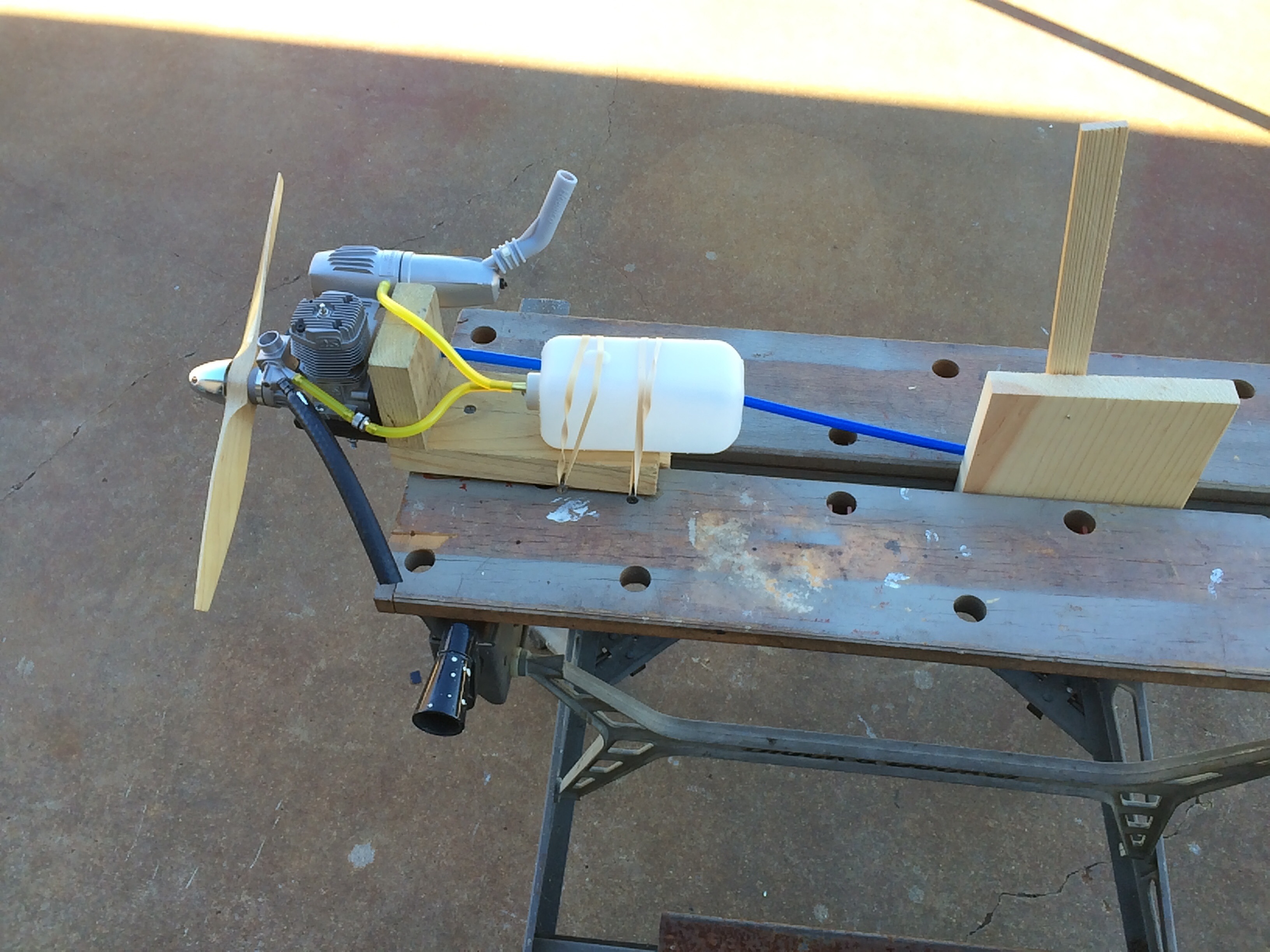

But, today I got to start my OS engine. It went well with a few minor problems. I couldn't figure out fuel flow direction on fuel filter so I had to open it up. Spinner came off on first start attempt. Flooded engine. Had to check for hydro lock. Didn't know the glow igniter had a twist to lock feature. took a while to figure how to get it off. Just minor stuff.
Then the the engine started and I went thru the run in procedure for a full tank. It sure felt good. The fuel smell brought back memories. Hope to have a plane in the air next week. Then the more difficult starts.
I made a simple engine test stand and also a temporary fueling station.

I have one area of concern, though. To me, it looks like you have gas fuel line for your glow test rig. If the others concur, you may want to swap out the fuel line.
John you are correct. It is an OS .55 AX. OS is the only engine I have ever used. I now have a Valley View gas engine for a second plane. My plans sort of changed along the way. So I now have two planes. The glow is about ready to go and the gas for later. What have I gotten into!!!!!!

Actually, I find gassers to be easier to deal with than glow engines. They stay in tune and are easier to hand start than glow engines are. And they are so much cleaner.
I just wanted to note that all the AX's come with a three inch length of flex cable that inserts into the needle valve to provide an extension and without the problems noted by Jaka. Even has a nice thumb wheel for the other end. I find this very nice and I normally leave them full length on all my AX's and I have a bunch. This is especially appreciated on some of my multi engine airplanes.
The pictures above are a .35 AX engine.
John
Ah!!! Vibration. Never thought of vibration and the rubber hose. I did hold the hose straight during the engine run so vibration should have been minimal. Still have to think about these things. I did balance the prop. It is something I did not do when I used to fly. Learned about it here. Lots to learn on this forum. Thanks.
John, thanks for posting the photos. My engine did come with the needle valve extension. I thought it was for airplanes with engine cowls. I will install it and give it a try. My old OS had a straight needle valve bringing you close to the prop. This engine has the angled needle valve which is better. The extension will make it much better and safer. Thanks.

the included extension has low mass so does not cause problems compared to a heavy tube. Use locktight on those set screws!
Because little brass knobs are hard to find in the grass...don't ask how I know!
Regarding the set screws ET on the OS included extensions do remember the set screw is a metric size both in the needle valve and the included knurled thumb wheel and its quite small I cannot off hand the size, remember these won't work if you use the wrong tool .
I think I have around 18 various AX's I use them a lot and in particular on the multi engine airplanes up to four engines (Did a sixer one time also but it finally died) and of course for the reason Ozmo indicated above, I have never had any problem with vibration affecting the needles, This is one of major reasons I like these engines so much and that is the ability to run long needle extensions.
I have never used any kind of locktight though simply because I wanted the flexabilty to make changes easily but I have never had the cable fall out of the needle valve or the knurled wheel 's fall out perhaps because I used the right tool and properly tightened them.

Well I have the needle valve extension installed. I did find that the hex nut was MM, 1.5MM. I thought about using locktite but went without. I changed out the fuel tubing to glow so engine is set to go. I just need to check and set the idle. Looks like it will be a rain event this week in Texas. Will need to wait for that flight trial. Time for double n triple checking things.
