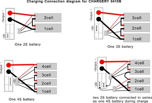

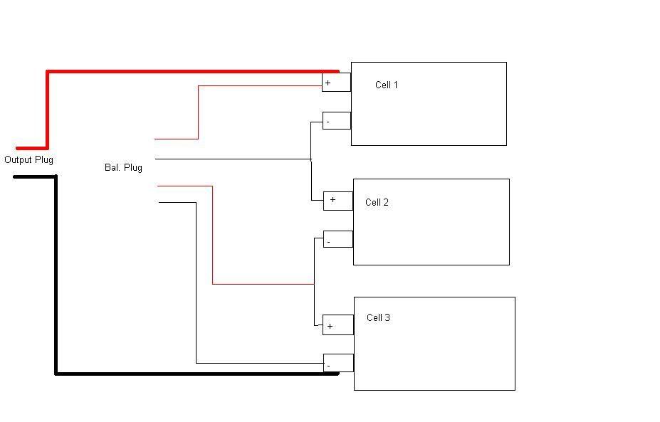

Originally Posted by SoCalErv (Post 12630826)
The LiFe packs have less availability in sizes as the LiPo on the site you provided so I thought I would assemble exactly what I wanted.
As for the Sullivan 6 volt fuel pump I have searched but can only find the 12 volt.
I will need to understand your comment "solder both main conductors AND balance leads". Google here I come.
Typically the cells in a pack are in series, to get the voltage one needs - that is pretty obvious. But, over time one or more cells charged over just the series connection may not charge up in the same amount of time, leading to an "unbalanced" pack. That cell when used then hits bottom before the others, potentially ruining it. So separate positive leads are also run from each cell, with a common negative, and plugged separately into the charger. Chargers will then monitor the voltage of each cell to ensure they are all at the same level before charging stops. Plain series charging can take a little less time. Balance monitored charging can get a few more mah replaced back into the battery.
Bummer - it seems like Sullivan doesn't offer the 6v any more. I would assume that using a 3S would be fine, although it may pump a bit slower than "normal". It's just a motor and a switch, so shouldn't be very sensitive.
ETpilot 09-10-2020 05:59 PM
One thing with buying battery packs you have to make sure you get the battery with the correct connector for your use. There are many different connectors In use. Store bought packs may have multiple power leads. Like a plug for your receiver, deans plug for charging and other uses and a balance lead and plug.
Here are some diagrams which will help in the wiring. The thick red and black leads would power your load. These would have the connector that you use. The thin leads are the balance leads which have the JST-XH balance connector. When you balance charge, you plug both leads to the charger. The charger measures the voltage and charges so each cell is close to the same voltage. Non-balance charging you would connect just the power lead. Balance leads have one more lead than the number of cells. So 3s has 4 leads.
JST-XH connector are inexpensive and can be purchased from Digi Key. Along with the pins. Batteries are running $6.55 for 2.5ah and $5.49 for 1.1ah. Minimum of 5 and I think you can mix them for the 5. These have no tabs. Stortronics.
