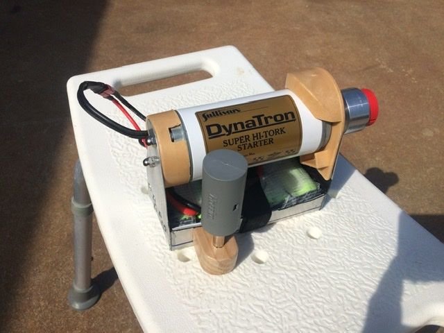

When I got back into RC I looked at the batteries available as it all had changed. I decided to go with Life and A123 batteries. Now I’m building a few foamy aircraft and starting to look at Lipo’s. Here is my starter setup. I made up 2 3 cell A123 packs wired in series. It gives me just under 20 volts. Plenty of power and battery life lasts a long time. Life batteries I charge in the airplane and just leave them as is wherever. Lipo requires special handling and care when charging or leaving for non use; storage. They require that you remove the battery for charging. I’m new with Lipo batteries so others may comment. I’m learning a lot about Lipo batteries.
That's pretty much the design of the battery tray I also use with my Dynatron, except without the handy ni-starter caddy. I used some G10 fiberglass board for mine, but 1/8th plywood would also work. If using wood, I would cover the outside with epoxy/fiberglass cloth to encourage all the seams to stay together, and help protect it from the knocking around it naturally gets.
Just make the tray big enough for the battery, with room above so you can easily grip the starter and squeeze the start strip. I made mine a bit too tight, so it is hard to get the battery in and out, but since I just charge it in place anyway, it is only very rare times I need to wrestle with it. Physical length of the battery is probably the only real constraint. My battery is crazy big - 5000 mah, which is probably why it lasts all summer. You could go much less in mah (1000?) and still go a long time between charges. I'll do that if the current one ever dies. Going on 6 years though...

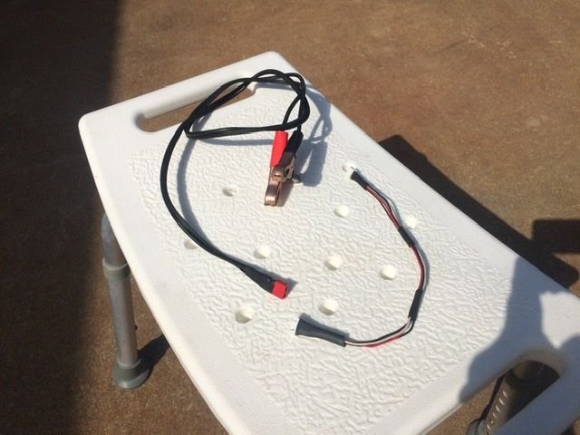

Yep... very similar set-up to my starting rig also, and I like the igniter caddy... nice touch there.
The LIFe batteries are nice in that they can safely be left in the plane and charged, where the LiPo's are best removed from the plane, and charged in a firesafe environment. Many of the accidents I've read about were from user error, so particular care (as always should be taken), needs to be taken when selecting charge rates/voltage/etc... If a LiPo is charged at a higher rate then recommended, it's likely to smoke, and spontaneously combust. When used and set correctly, and placed in a firesafe environment, it obviously reduces any chance of damage or malfunction significantly. LiPo technology has evolved, as well as user awareness, with those aspects malfunctions and accidents have reduced, but you can never be too safe with any battery, regardless of chemistry... just be safe and study all aspects. Much of it is about awareness.
I believe each type of battery has it's application. I use Li'fe's in my planes up to about 50cc size engines, and anything bigger then that I use LiPo's to take advantage of the higher voltage and power.to the servos/systems. Nice thing is most every modern charger will charge either type of battery as well as several other types. Once you get accustomed to modern battery technology, there's no turning back. I know I'm hooked, and there's several options these days to accommodate many different components.

I made my battery tray from aluminum I had in the shop. Bent and riveted together. I coated the inside with an insulation coating. I used coroplast as an additional insulation. I didn’t have battery shrink tube so I used heavy duty strapping tape. Main thing was to keep those batteries from ever touching the aluminum.
The cut off battery cord I added a deans connector and keep it for maybe an emergency. I also made a long balance extension cord. I charge the batteries without removing them.
