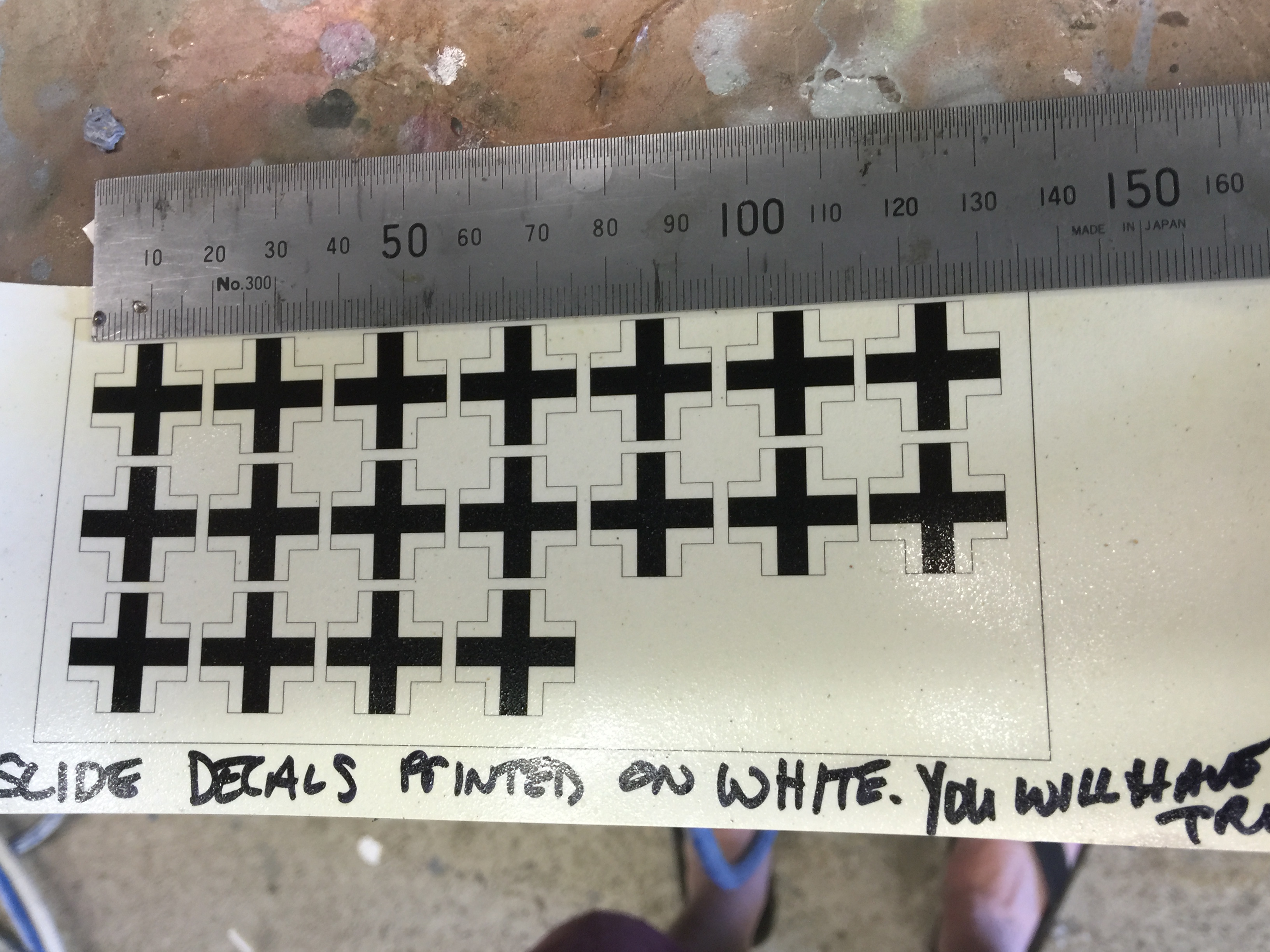

Gray Beard 07-01-2015 04:31 PM
2 Attachment(s)
http://www.rcuniverse.com/forum/atta...mentid=2106821http://www.rcuniverse.com/forum/atta...mentid=2106822 Peter, your over thinking this for something very simple. I did a demo on making this Blue Meanie when I did a build thread on the Prime Cut + 20 and you can look it up. It's just a mater of making template copies on my scanner with bond paper then cutting out the colors from covering. Been a while, I think 2013 but all you would need is a sharp Exacto blade and some black covering and a steel ruler or straight edge to make those. The other logo I did was for the Bridi Dirty Birdi. I did it the same way.
rlipsett 07-02-2015 05:53 AM
if you have a scanner then scan and print it on your clear decal paper. white is never printed when making decals it is usually the white of the background of the paper stock you are using or the white background of the area of the plane that you are putting stickers over. question are you sure the decals are printed on white decal paper or is the decal paper clear with a white backing that is removed before application?
just looked close at pictures it is on white decals. scan or take good quality digital photo and reprint
