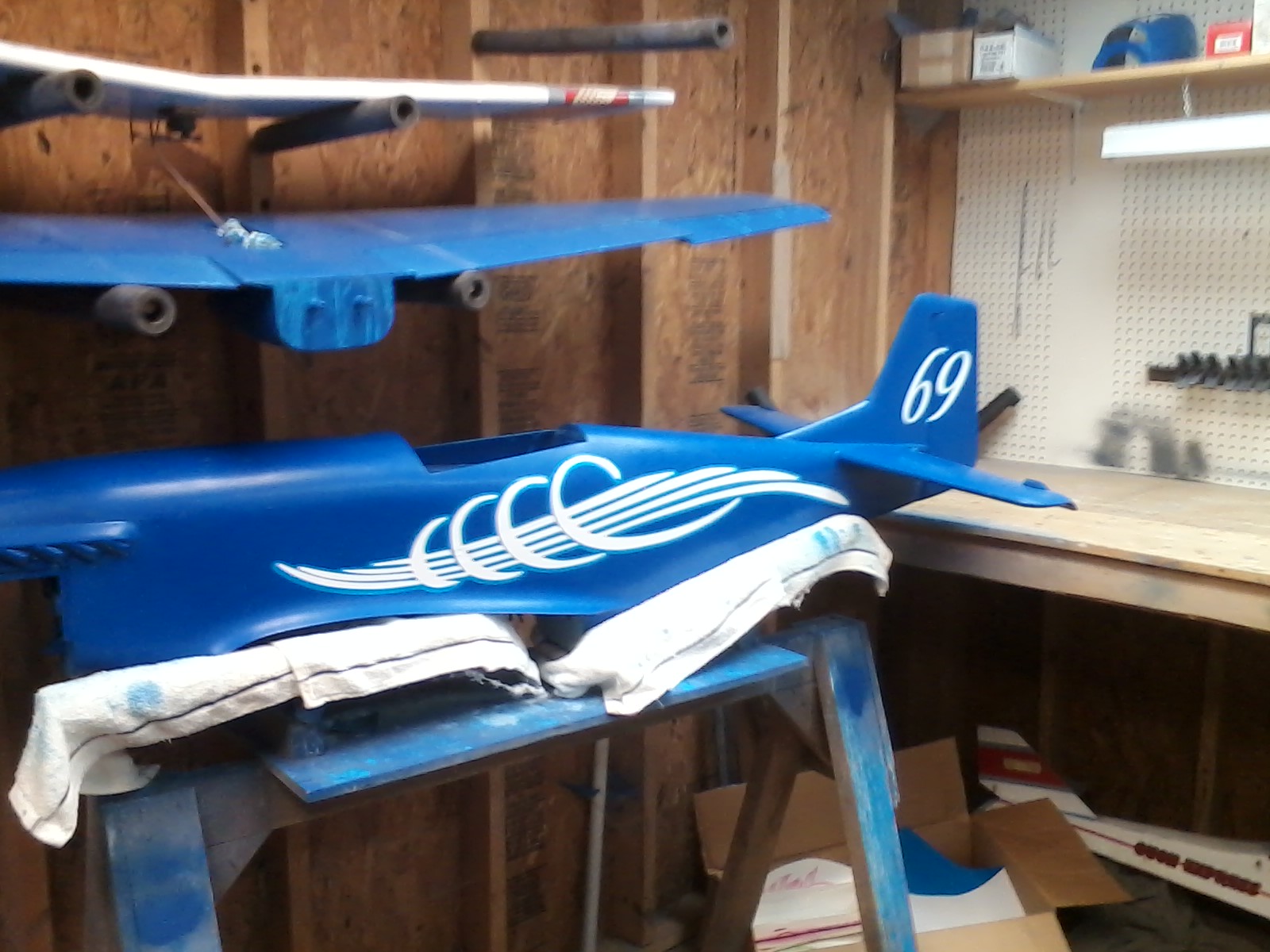

Guys if you want to make your own decals. Do what I did, go buy you a vinyl cutter for hobbyist. I think I spent $300 for it and it has worked out really well. Vinyl doesn't cost that much, I get mine from US Cutter and a 12" X 5 yard roll is around $9. You will also need to get transfer tape. Below are some pics of the decals I have made so far for my P-51. The woman is my nose art. Calling her Sexy As Sin

Lets see here. You think paint is thinner. Well the average paint thickness is 6 - 8 mils. You can get vinyl in 2.2, 2.5, 3, 4, 5 and 6 mils. I use 3 mil vinyl. Even waterslide decals are around 3 mils thick. No matter what you use there draw backs.
