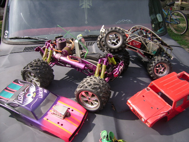

Hello, I'm wondering what would be the best way to prep a nitro engine for long term storage?, well not storage really as they are on display and only get brought out on very rare occasions....(once in the last 5 yrs.).........these engines are in a Tmaxx and a Savage that belonged to my son who passed away in 2005, I have put after run in them but they have "locked" up twice since sitting on the shelfin our home... any Ideas?Thinking of pulling the rod and piston from each and storing them that way, but I'd really like tokeep them in running condition if possible.........Thanks,Steve
