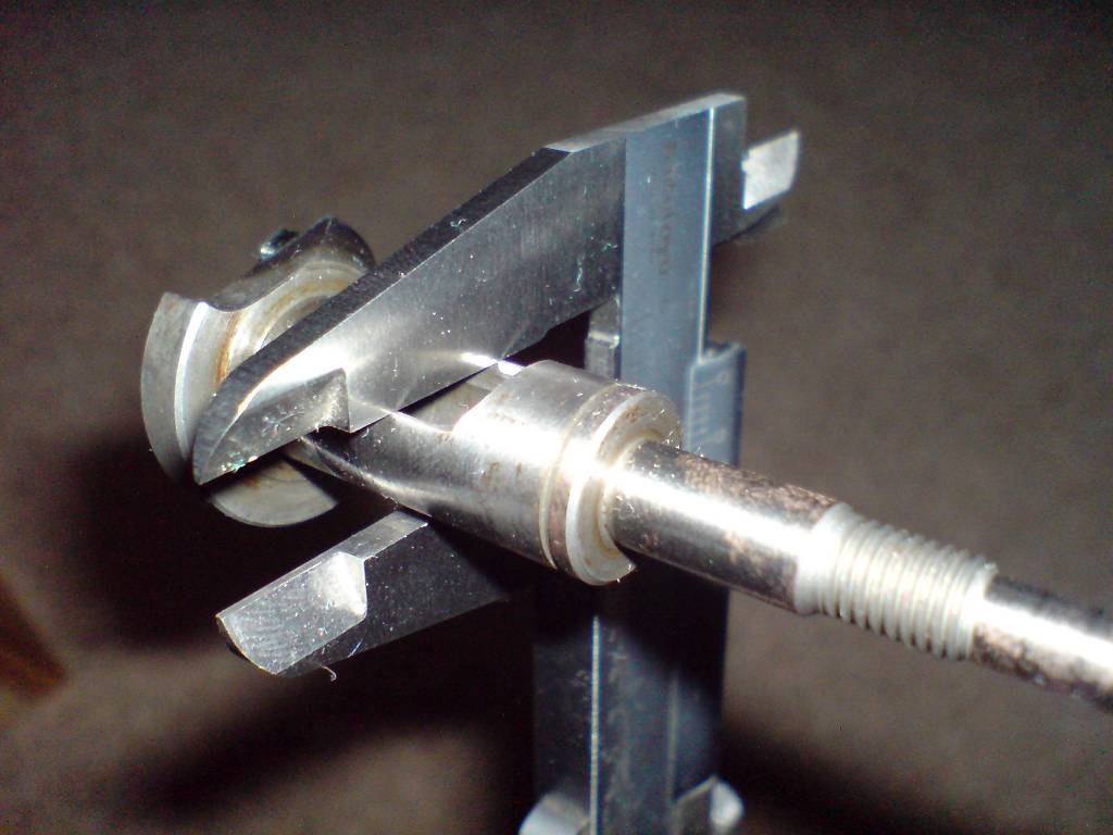

Hey savagejim or downunder i know that these post are old but reading them over and over and trying to duplicate what your saying to do is tougher than i could have imagined. i am not a stupid person but im feeling that way trying to time my mill out, when im measuring for HTOT on my crank am i measuring from the top of the crank or the top of the whachamacallit i dont know the actual name for it so i took this picture, from this info i can figure out the rest of the measurments because they pretty much start at the same spot except H1 is that the middle of the whole on the crank?? thanks in advance for the help.

Step A: Now we need to measure Htot (see Diagram 1 below). This is done by putting one of the flat sides of the caliper so that the two edges of the induction port are against that flat side and the other side is on the opposite side of the shaft. Write down this number, this is Htot.
The induction port is the square shaped hole along the length of the shaft. Picture below.
You do not have to measure H1, you calculate it from the other measurements.
Step C: Next we need to calculate the H1. This is also done by doing very simple arithmetic.
H1 is simply Htot (the measurement from Step A) minus R (calculated in Step B).

Hey thanks Anthoop i was on the wrong track but its good to you guys are out there sorry about all the stupid questions i will get this stuff sooner or later im thinking later though.

so the induction port would be the W1 correct?

Ok i get it thanks for that pic as i sat and thought about were you were measuring from the light bulb finally went on and the numbers are more acurate. Still not sure of the trig stuff and how to use excel but i might try the timming wheel instead any thoughts?

i now know its HTOT not W1

ORIGINAL: DMOne
It is only maths...who is excel?
The timing wheel can give you opening and closing point in relation to the piston, a simple calculation from that will tell you duration.
