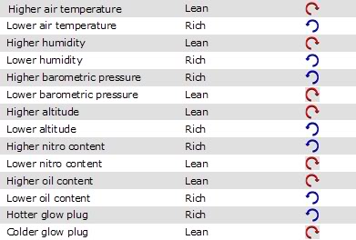

Nitro Engine Tuning Basics:
NOTE: ALL TUNING MUST BE DONE AT OPERATING TEMPERATURE
Rich: An excessive amount of fuel entering the engine, more fuel means more oil, which
typically lowers the operating temperature. Rich=counterclockwise
Lean: An insufficient amount of fuel entering the engine, less fuel means less oil, this
causes more friction, higher temperatures, and engine damage. Lean=clockwise

Here is a good little graphic that for the record I did not make, I simply found it very helpful.
Attachment 2239705

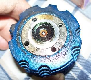

How To Read Glow Plugs:
If you know much about 1:1 scale car racing, you will know that teams examine the spark plugs that have been used in the engine while racing, then they use a method called “spark plug reading” to determine how the engine is tuned. Well for scale model cars running 2-stroke nitro engines, there is a method of doing this. It is called “glow plug reading”. Here is a general how-to guide on reading glow plugs. (Note: this is meant for new glow plugs, it cannot be accurately done on glow plugs that have been run for a while)
1. Wire and surrounding bottom of plug wet, with like new shiny wire = rich side of optimum power
2. Wire and surrounding bottom of plug starting to dry and wire starting to gray = very close to optimum power
3. Wire and surrounding bottom of plug dry, wire totally gray but not distorted optimum power
4. Wire and surrounding bottom of pug dry, wire distorted = slightly lean "DANGER!"
5. Wire and surrounding bottom of plug dry, wire broken and distorted or burnt up = extremely lean possible engine damage!

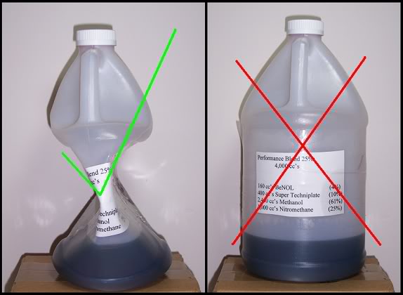

Proper Fuel Storage:
Yes, there is a proper way to do everything, even storing your own glow fuel. Ever noticed when you are almost finished off with a jug of fuel, that there is a lot of empty space in the jug? This is the perfect opportunity for condensation to form in your fuel jug and contaminate it. Below is a picture of how to store your fuel. All fuel should be kept in a cool, dark, dry area if possible.
Attachment 2239706
Try to squeeze as much air out of the jug as possible, but be careful, squeezing the jug too hard can puncture an edge (like I have done) and therefore ruin the jug.

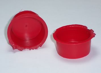

Remember these little things?
Attachment 2239707
Whenever you open up a fresh gallon of fuel, make sure to put this back in the top to provide a moisture barrier.

I understand the physical/theoretical reasons for running lean in warm weather and rich in denser cold weather air, but my experience with my Pro.15 has been... unique.. in that sense. ;)
hpi apollo 03-08-2007 10:44 PM
RE: Nitro Guide and FAQs
you DO NOT use your hsn for a temp adjuster, when you are in cold weather you need to run richer because cold air is more dense, and more air per voulme of fuel makes it run lean, you need to run richer, but you also might have to cover up some windows to keep the temp up, or if that doesnt work, you need to wrap a paper towell around the head or maybe some foil
Slo-V Flyer 03-08-2007 11:04 PM
hpi apollo,
If you read my post you'll see that I understand how cold air is denser and all and warm air is thinner. What I was trying to say is that if I run in cold(er) weather say 45-50'F, the engine may warm up, but it will simply not run at optimum rpms, meaning it will run like it's too rich and just not have acceleration and speed. It's after a turn it a 1/8 - 1/4 turn leaner that it really starts to work right (smoke trail is just right, sound is just about crisp). In fact I seem to have better luck in cooler weather with respect to the engine running consistantly, while in warmer weather (65+) I'll usually have to go in and richen it as the tank gets low and it gets above 270'F if I don't. So I'm not disputing the "rules of r/c nitro tuning," but simply pointing out an interesting observation. BTW my truck body does not have open windows/windshield, but simply relies on the cooling hole I cut above the engine to shed the heat out, so at least that much is not keeping the engine from heating up in cold weather.
However, next time out in cold weather (whatever of it we have left here in Texas ;) ) I'll try to cover some of the heat sink and see which way I end up tuning the needle, and the effects on performance. Again I don't try to use the HSN as a thermostat, but usually try to strike a balance between power and heat. Maybe I'm still wrong but hey can you blame a nitro novice for trying? :D I mean the Pro .15 manual says to keep it at 225, which I can agree is is kinda low, and here you guys are saying that engines *can* be run as high as 270'F range. Who do you suggest I trust with my $110? :D I think I'll strike a balance of both (if possible).
hpi apollo 03-08-2007 11:14 PM
only in cold weather do you need to cover your cooling head, if you do it at 45 degrees then you will overheat your engine, what im trying to say is that if you have enough coolign holes in your body for your engine to run at maybe 240 at an optimum tune, whenever it gets to like 30 degrees you iwll need to block some holes
Slo-V Flyer 03-08-2007 11:42 PM
I understand you're saying. I guess "cold" is a relative term, since I usually don't find it enjoyable to drive my cars if it's colder than 40-45'F and windy (the wind usually kills the fun). I don't see myself need an "r/c" fix in 30'F weather but I'll keep in mind about covering the heatsink if that ever happens. Yet another "interesting" aspect of nitro. ...Hmm... I wonder if my IB4200 is charged.... :D
JayC1968 03-09-2007 05:30 AM
OK......... we are not in a battle I HOPE... Eric has done something that MOST will not take the time to do. His friend also took the time to help the man and that man's name is, rccardude........
So before we try to take what is written, take time to read it.
People do have different opinions but some people like to to voice what they know. I personally like what HPI Apollo has wrote with the help of his friend rccardude......
These are people that know RC, and even though I have 20 years in the hobby, I can still learn.
JayC1968 03-09-2007 05:39 AM
ORIGINAL: nickh
I just joined this forum and i'm new to the rc scene but I do know this methanol will only condense into droplet at extremely low tempratures.
Methanols evaporation point is around 75 degrees f and it freezes at -126 degrees f. You can pretty much bet that condensation build up on the inside of a bottle is from the air content inside the bottle from infrared heating.
I use methanol extensively in my occupation and at temprature down to -75 degrees f and I have only scene it condense to droplet at temps below 0 degrees f.
Nick
DO NOT get it wrong........ I don't care..... NITRO Fuel will evaporate at a faster rate than METHANOL... We are not talking just one composite... we are talking two ............Methanol will and DOES evaporate at room temps and up to 120 degrees....I do NOT give a rats ass who you are and what you do.......... I see it and so do all the nitro car owners that store fuel,,,,,,,,,,,,,, so blow me
hpi apollo 03-09-2007 08:13 AM
ORIGINAL: JayC1968
ORIGINAL: nickh
Nick
dude, chill, we dont wunna start a flame war over something small, methanol will evaporate at any temp above its freezing point, just very, very slowly, at room temperature it will evaporate with no problem, and then consdense on the isnide of a jug
hpi apollo 03-10-2007 03:11 PM
