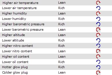

NOTE: ALL TUNING MUST BE DONE AT OPERATING TEMPERATURE
Rich: An excessive amount of fuel entering the engine, more fuel means more oil, which
typically lowers the operating temperature. Rich=counterclockwise
Lean: An insufficient amount of fuel entering the engine, less fuel means less oil, this
causes more friction, higher temperatures, and engine damage. Lean=clockwise
High Speed Needle:
The High Speed Needle (HSN) valve is the tall valve that sticks out from the top of your carburetor. Its job is to control the main flow of fuel to the carburetor. If you lean out the HSN, the LSN (Low Speed Needle) will be automatically leaned too (think of it this way, the HSN is the garden hose faucet which controls all of what goes in, the LSN is the nozzle which controls the exact amount that comes out). The HSN mainly effects the top speed of the car. If your HSN is set too rich, the engine will typically not reach its full RPM potential. If the HSN is too lean, you can experience hesitation, overheating and flameouts (engine instantly shutting off at random or at higher RPM’s). WARNING!!!! The HSN IS NOT to be used as a thermostat. Yes tuning effects running temperature, but only half of it. In the cold, you will typically have to set your needles richer because cold air carries more oxygen, therefore with the previous settings you will be running too lean.
Low Speed Needle:
The Low Speed Needle (LSN) is used for fine adjusting the rate of fuel flowing into the engine from the HSN. If your LSN is too lean then you will have erratic idling, it might want to drive off without you, and it can suddenly shut off (flame out). A characteristic of an overly lean LSN will be a random surging and sound “angry†so to speak. It also will have sporadic RPM increases. Too rich of a LSN will make the idle sound deep and rough, at idle the RPM will slowly decrease and then shut off due to the excess fuel building up, it will also cause consistent sluggish acceleration all the way up the RPM range, and this is what makes it different from a lean bog.
The best way to test your LSN is to get your engine running at normal operating temperature, drive it around, and then let it sit and idle for 30 seconds. Once 30 seconds is over, apply a lot of throttle, if it is rich you will notice slow, gurgly acceleration, if this happens, lean the LSN out by 1/8th of a turn and then test it again, if it is lean, chances are it will flame out or have random surges. In this case you would richen the LSN up by 1/8th of a turn at a time. Your LSN will be set near optimum position when you have little to no hesitation after 30 seconds of idling.
Keep in mind that an engines tune changes day by day, every time you get our your engine and run it, you should tweak the needles a little bit (typically). One day your engine can run fine, the next day it can be running extremely lean.
NOTE: Tune the HSN first because it controls the full amount of fuel entering the carburetor, and then tune the LSN because it is a fine adjustment screw.
As a side note, if you do a lot of wide open running at WOT (Wide Open Throttle, a.k.a. full throttle) your engine will need extra lubrication and it could need to be set 1/4th turn rich to ensure proper lubrication to your engine at high RPM’s.
Here is a good little graphic that for the record I did not make, I simply found it very helpful.

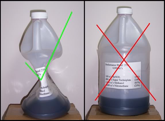

Proper Fuel Storage:
Yes, there is a proper way to do everything, even storing your own glow fuel. Ever noticed when you are almost finished off with a jug of fuel, that there is a lot of empty space in the jug? This is the perfect opportunity for condensation to form in your fuel jug and contaminate it. Below is a picture of how to store your fuel. All fuel should be kept in a cool, dark, dry area if possible.
![Click image for larger version
ID: 2239706](https://www.rcuniverse.com/forum/attachment.php?attachmentid=2239706&thumb=1&d=1524196299)
Try to squeeze as much air out of the jug as possible, but be careful, squeezing the jug too hard can puncture an edge (like I have done) and therefore ruin the jug.

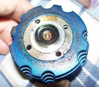

Synthetic oils are typically derived from refined petroleum extracts, and are often chemically altered to be a custom friction modifier. Synthetic oils are cheaper to manufacture, therefore most fuel companies make this a majority of their oil content in a gallon of fuel. Synthetic oils are just as “slippery†as castor oil, but the main difference is that castor oil does not typically burn in the combustion process, while the synthetic oil is often completely consumed. Synthetic oils provide very little over-lean protection when being used.
Some fuel blends from Blue Thunder run full-synthetic oils in them. I have had personal experience with these and do not like them because they are not very forgiving if you run lean. However, many have had success with them; with the right needle setting you will get great protection from them as well. Just as an example, here is a picture of an O.S. 12TZ that was ran a little too lean on Blue Thunder.

Why do we ‘tune’ our engines? How is it done? This guide assumes that you are familiar with all of the parts of your R/C's engine. If you are unsure what a Low Speed Needle (LSN), High Speed Needle (HSN), idle screw etc are, please refer to the manual (RTFM).
Tuning a nitro/methane 2 stroke engine literally means adjusting the air/fuel mixture inside the chamber. This is done by means of adjusting the amount of fuel that is allowed to flow into the carburetor via needles which can be opened and closed. Most of us know that there are a wide variety of factors that affect that air/fuel mixture in the chamber other than just adjusting the needles. Because of this an engine may have to be tuned several times in the same day for optimum performance. Not maintaining an optimum air/fuel ratio can result in poor performance, or even engine failure!
There is a point, in every engine, at which air/fuel mixture will allow the engine to obtain its maximum HP and RPM’s. Tuning your engine to that point can be dangerous, as the mixture is somewhat lacking in the lubricants necessary to give maximum protection to the engine. Therefore, most people will want to run slightly rich (more fuel in the mixture) of that point. This is referred to as the ‘Sweet Spot.’ Some racers will run at pure max potential, but they also don’t usually care if the engine only lasts a gallon… Running at those settings can be very dangerous because being too lean is just a very slight adjustment away.
And running lean is the real engine killer, not temperature. With proper lubrication, the internal components of an R/C engine can easily withstand temperatures of 300F, maybe even more. The thing is, these engines are designed to operate at temperatures around 210 – 270 F. While there is the possibility you will encounter an engine and conditions that dictate the temperature at proper tune is over 300, it will be a rare occurrence. What that boils down to is that there is a good possibility that there is a problem if your engine reaches too high of a temperature. That is why it’s a good idea to monitor the engine temperature, but not use it as a guide for adjusting the air/fuel mixture in the engine.
So, how do you get to that ‘Sweet Spot?’
1) Start out with rich settings. If you are unsure how to go about this, an easy way is to start with stock needle settings. This includes the idle screw - make sure it is set at factory settings, usually a 1 or 2 mm opening for the idle stop. The factories always set engines rich for break ins.
2) next, warm up the engine. Try not to hammer the throttle too much while its still bone cold, but slowly work your way up to a couple WOT runs.
3) Now that the engine is warmed up (1/2 tank is good), do a couple WOT runs of about 50-100ft in front of you and pay attention to the pitch of your engine. The higher the pitch, the more RPM's its doing.
4) Now lean out the HSN by 1 hour increments (30 degrees, 1/12 of a full circle etc) and continue to do some WOT runs in front of you. The engine's max RPM's should continue to go up each and every time you lean out the HSN by those 1 hour changes. If it doesn't, you have reached the top end and need to richen by an hour. Make sure that you do not continue to lean out the HSN after max RPM's have been reached. You will damage the engine.
Congratulations, you just found the sweet spot. Now, if you notice that the car/truck bogs a bit at take off, lean out the LSN (again 1 hr increments) until it will take off at the touch of the trigger.
And you're done. At this point I like to temp the engine to get a baseline reading for the day.
This is a simple and fool proof method of tuning that everyone can do. Regardless of your experience.
