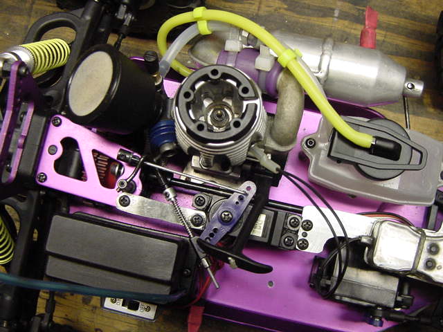

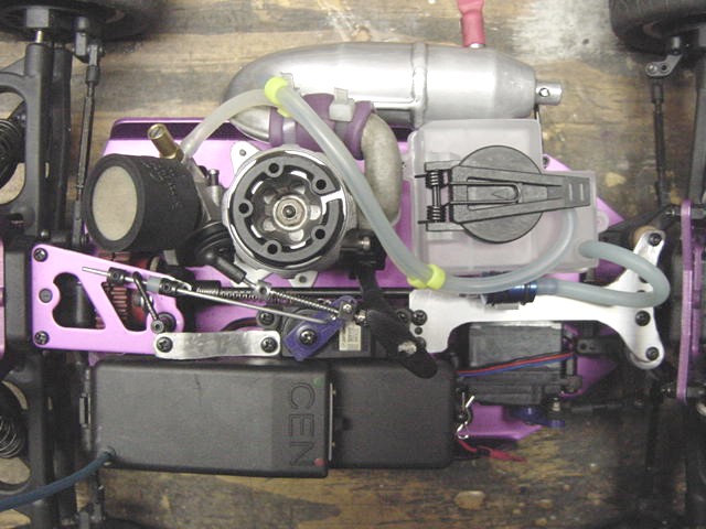

does anybody know if a traxxas 2.5 engine will fit right in place of the .16 stock engine???

The Traxxas 2.5 engine will fit the MT2. The Traxxas speed is about 10mph faster than with the Cen .16. I recommend only using the single speed setup with this engine.

Yes as you can see from the picture, rear exhaust engine fit nicely into the MT2. You will have to use, the TC3, or OFNA exhaust manifold and pipe however. Other then that, they are an exact fit. Acutally any small block engine will fit right in. Big blocks will fit as well, but they may need minor tweeking. Such as turning the carb at the correct angle etc.
