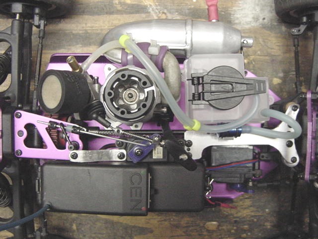

I find that by adding a full length brace between the shock towers almost all unwanted movement in the diff/brake area is eliminated. All I did was add an 3/16" aluminum rod that was drilled/taped on both ends to receive a 3mm screw which in turn attaches to the two shock towers. Seems to work well so far for overall chassis stiffening and a nice carrying handle/roll bar.

a t-maxx engine on the cen...almost a crime... just kidding I own one myself... how does it run, any faster?... I like the brace idea.. how long have you run it this way? can it take alot of abuse? This seems like one of the easier chassis fixes i've seen....

digout,
You have posted pics of your truck with the OFNA tank using a front fuel pickup location. Have you had a chance to run this setup and does fuel pickup location give any problems. I have this tank and was wondering if I needed to reverse the tank.
I have seen the upgraded receiver/battery box that you mounted on another thread but don't remember who makes it. Do you have the manufacture's name, item number or a link for this.
Thanks for any information you have.

bolegs,
I have run the ofna 1/8 scale (125cc) tank with no problems since it has plenty of internal baffeling. It can be mounted opposite direction with some minor changes. I tried it just to have longer run times. I plan on using the smaller 1/10 scale ofna pirate 10 (90cc) tank next as it is more suited for the MT2 chassis.
The receiver/battery box is from an Ofna Pirate 10. Using this box allowed more linkage clearance from when using a slide type carburetor.
Later I will be trying out a set up with a rear mounted Cen battery box and a small GT receiver box in conjunction with the Ofna P10 fuel tank. I am just trying to find the best balanced layout.
