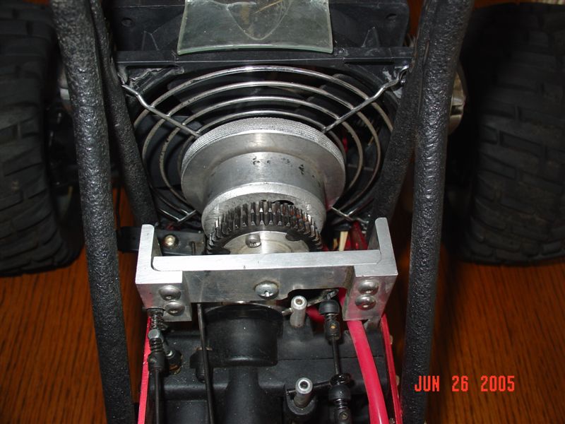

Werent the gears on the Genesis LE supposed to be stronger? I took my first trip to an open field to test out the new shift point settings, and lost the small pinion (GS089 17t). The only driving i did were some high speed passes, and some runs in and out of a ditch that surrounds this field. I was a little disappointed to hear the clicking, crunching, grinding.... Any thoughts on this CENracing?

Really? Well CEN replied to my e-mail, and told me this...
Matt,
Those gears are solid and will usually last a long time. When those gears go out its usually a case of a gear mesh gone bad. Those parts aren't normally replace under warranty but we will replace it for you if you'd like. I just don't suggest it because the shipping alone will cost more than it does at RCmodels. My best advice is to buy one there and put it on the bell. After you re-install the engine in the truck be sure that the pinion gears are pressed tightly against the spur gears. They should not move freely. The reason for this is that as the truck runs the vibration causes the gears to seperate slightly and run at a proper mesh. I'm sorry that I don't have a better solution for you, but after replacing that gear and fixing the mesh it should run solid for a long period of time. Let me know if you have any other questions.
Sincerely,
CEN Customer Service
714-792-1923
If his method is right, then my gear mesh was wrong. I was setting it close, but not to the point that it was binding like he says to in that e-mail. My first impressions are that the gears, AND bearings are going to get a royal thrashing. The gears are 10 bucks or less, so i'll try it. We'll see what happens. My shift point into 2nd was super early before. Leaving my truck shifting into second like a dog, and draggging badly until it hit 3rd. With both shift points later, the truck is performing really well. I'll give it some runs this weekend. I'll have my LHS order the gears tomorrow.

This is only a Genesis thing...normally bound or tight mesh on steel to steel gears will cause premature wear...
Since CEN does state this it is safe to do for their Genesis...

There was a guy on ebay from Italy selling hardened gears but I don't know if they are any better then the current gears. I bet all the gear problems would go away if CEN made a front motor mount. Kind of like the new support for the tranny gears. Better yet, extend the tranny brace up to a bearing on the front of the engine. I suspect that the tight mesh is to compensate for the engine torque forcing the gears apart when the engine, mount and chassis flex a little. I knew I needed a front motor mount for my conversion or it would never work.

Well, heres a pic of my gears...

ORIGINAL: ThermalRD
That's what my clutch bell gears look like right now. I was under the impression that gear mesh was supposed to be close but not tight, guess I'll have to try fixing that. Now if I can only get the carb fixed properly...........
