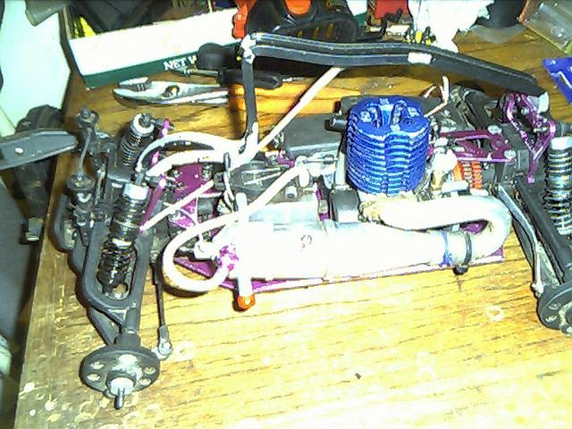

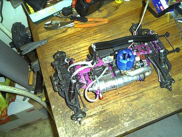

Check out the pics of the mods in my profile gallery. the mod from the servo mounts to the breake seat works good but the metal over the servo tieing the front top plate to rear took out all flex in my basher. If you cut the top plate for different fuel tank ect. Use the Metal posts for servo mounts. Hope the pics tell the story.

If any ones intrested I found the deck railing bracket I used to make my roll bar. lookup Aubuchon item #217422 . All it takes to make it work is one cut to seperate the end with ajustment hole then gently bend to fit and drill holes. Its a real light aluminum easy to bend just take it slow and steady. Nice they come two to a pack. hope you guys like?
