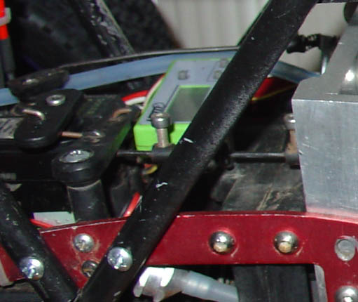

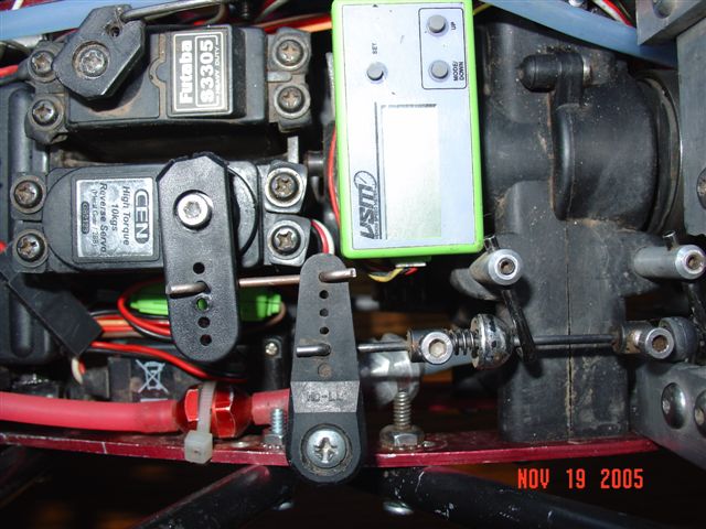

Here is an easy way to make the brakes work better on the genesis. I used the old style throttle pivot mount (my still be available in part no. GS082) but any piece of plastic will work if you drill the holes in it. The pivoting arm is an extra servo horn. You will need to drill holes in the chassis.
The servo will now use all of it's travel and the force is multiplied by the lever arm.
