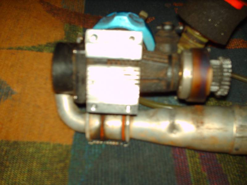

CEN or anyone,
Just want to know if any modification or change of engine mounts is required to install a .28 size motor in a Nemesis. MY reason for the change is that ROAR rules and most clubs maximum size engine is .28 for monster trucks. Any info would be great. Thanks.

Yes you have to modify the engine mount. It consists of re-drilling the top engine holes on the mount and cutting out the heat sink on the bottom, giving you two mounts.

Could you post some pics as to what it should look like? And what engine would you recommend in the .28 range?

here it is

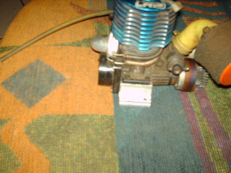

side view

well i run a lrpz 28 and it moves this truck with authority so should the sh28. you must remember the stock engine and pipe was very heavy at first my regular .28 pipe looked small on the truck until i removed the bumpers and left the skids know everything looks more balanced and im know going to 17/21 gearing were stock gearing was 21/25 on clutch bell
