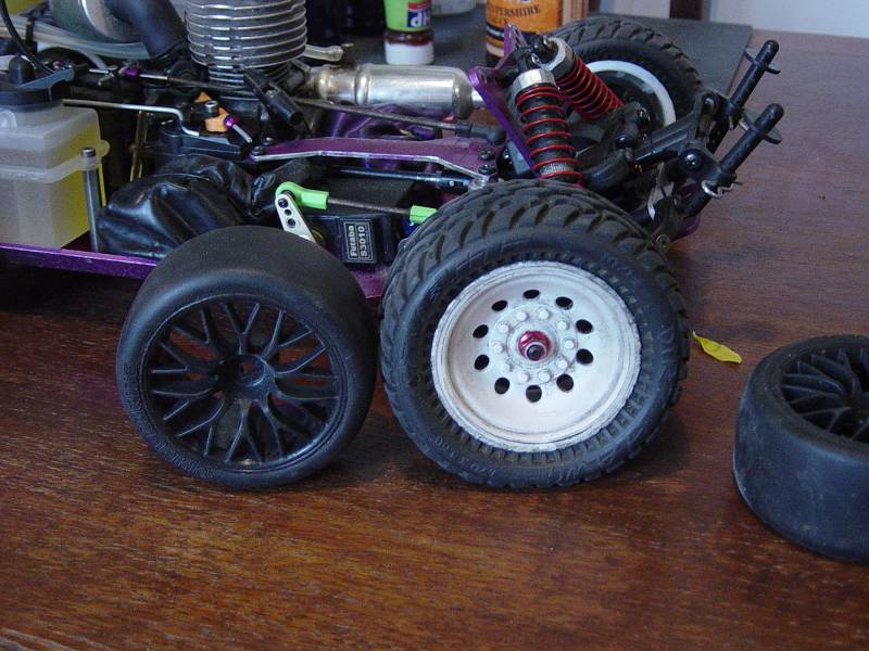

like scouser said - the speeds these things can achieve can be a bit scary with the rallys handling, especially on tarmac, but on loose gravel etc, its a lot happier it seems. i have mine setup with red associated truck/buggy springs on the front and cens springs on the rear, with 40wt shock oil all round. its got a fair bit of roll on high grip surfaces, and can get crossed up if i flick it from side to side too quickly, but on gravel and dusty surfaces its a great fun, powersliding machine. tyres are proline dirt hawgs for buggy rear wheels, which i have fibre taped on the inside and doubled up some soft foams to help with ballooning.
alternatively - u could set the suspension pretty hard and use some of HPIs 2.2" slicks. i have a set here, and they are pretty sticky, but theyre lower diameter too, which can both help and hinder the handling - gentle throttle is best for these, then they really are good against noob touring car boys... just drive over em...
