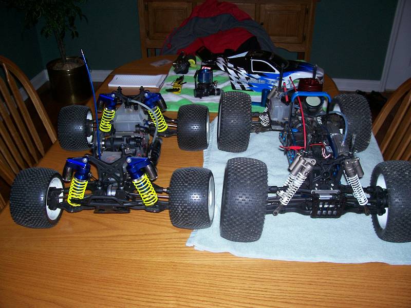

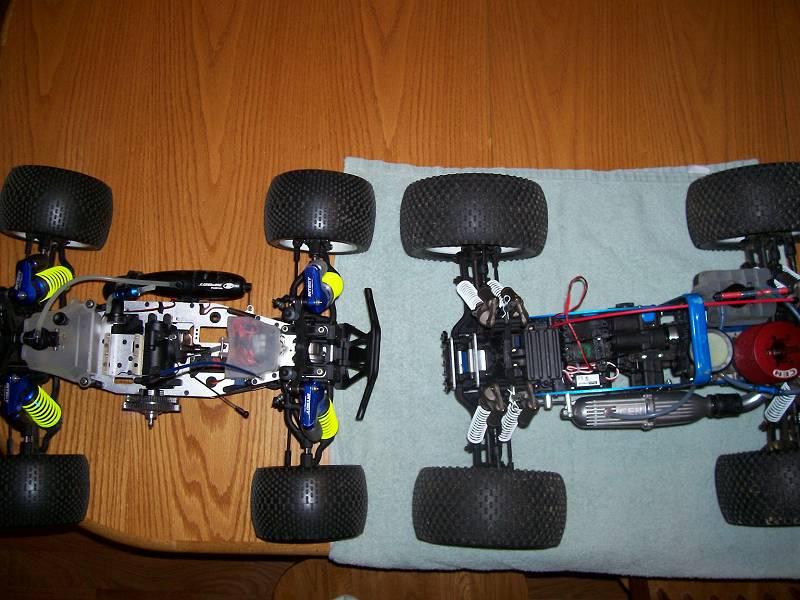

Here are some pics just taken, I am getting ready to try the tape and plus I am putting some new shoes in the LST to get it ready for it's next race. But as you can tell the LST stance is slightly wider than that of the Nemi. Just wanted to post these here to show where I mounted the shocks, plus I don't think I have ever posted these two together.

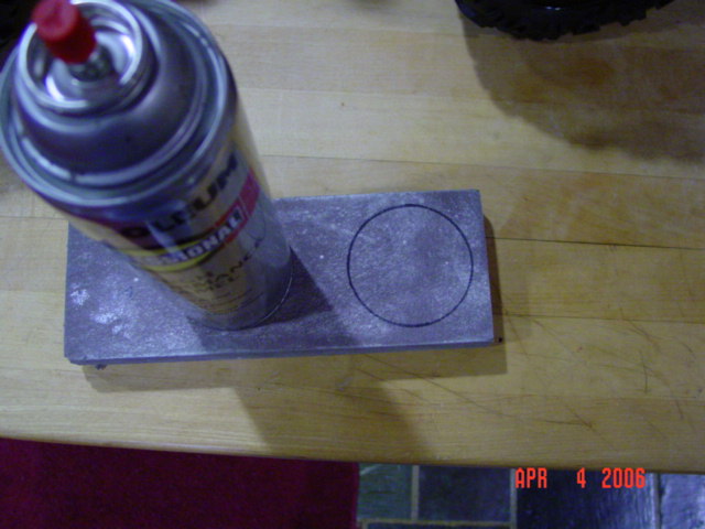

i think i have a solution on preventing the head being damaged. i have a piece of pvc and i'll see how i can fit it to protect the head.
Old 04-04-2006 | 09:15 PM
jombo's Avatar
Joined: Apr 2005
Posts: 2,417
From: trumbull, CT
Default RE: Nemesis wheel hop?

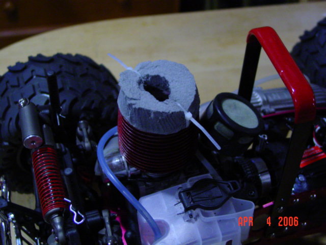

here is the shock absorber for the head, its 1 inch thick foam sanding pad. its very dense and the heat should not melt it since the head side is the sanded part. i put a match to it and it just put a black mark to it, well time will tell if it works.

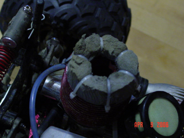

well i had first hand experience today with the truck flipping and landing on the head and the pad worked great, no head damage. but when going through mud and water well its a sponge, need i say more? but it worked like it was supose to. i will be making them for all my trucks now. and the ties all stayed on.there are 6 ties holding it and they compress the sponge abit so the ties arent actually exposed to damage.
