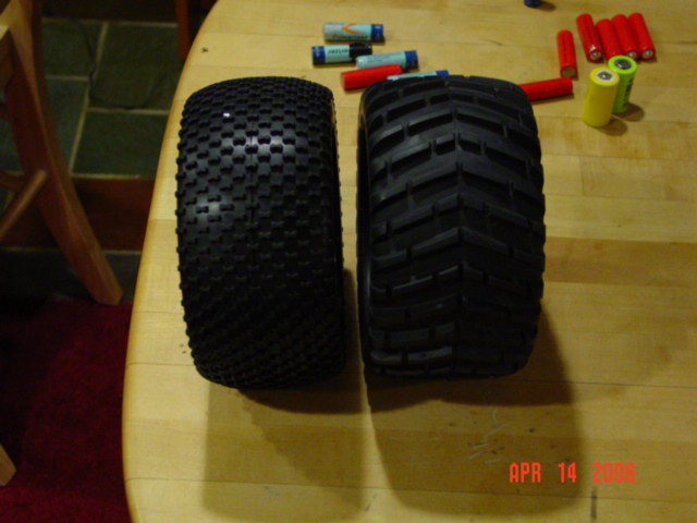

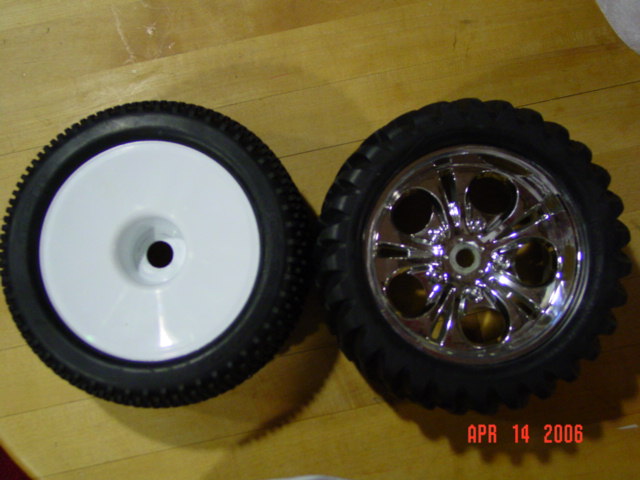

i think the only tires that fit may be the nemisis rubber, the genesis rubber overhangs the rim so it seems wider but the rims look like they are the same size.
ID:	445280   Click image for larger version

I know about the CEN Tires,what i want to know if there is an other brand of tires which may
fit the stock wheels.
