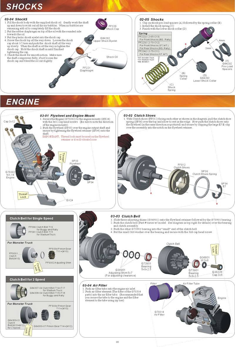

The two spur gears used in the MT2 are 1st 47T G84307-01 and 2nd 44T G84307-02 the pinions are T11 FFs034 and T14 G84303-07.
