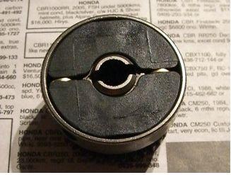

You can also try doing this mod to your third speed trany. This was submitted by another user to us and we have tested it and confirmed it works. View the pictures below.

Cen,
What is the modification we meant to be seeing in these pictures????
Old 06-19-2006 | 05:57 PM
CEN Racing's Avatar
Joined: Apr 2003
Posts: 1,516
From: City of Industry, CA
Default RE: Genesis transmission
The washers underneath the two clutch pucks.

Yeah, it is a mod that we have been testing to help third gear engage more consistently. Seems to be working in early tests and may become the standard in the future Genesis trucks!
So how thick are they or doesn't it matter???
Old 06-22-2006 | 01:53 PM
CEN Racing's Avatar
Joined: Apr 2003
Posts: 1,516
The ones we used were 0.030" thick.
