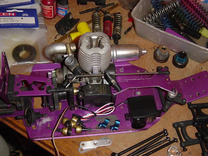

I just got my metal brake disc today and I can't figure out which way to install the dang thing cause both ways in the picures below that I did it it would not move correctly So which way is correct photo 1 or photo 2

I installed them like photo 2 with the flanges facing the front of the car. I had the same problem, the little flanges would catch. 1st, I dremeled the flanges down a little bit and round the corners off. 2nd, be sure when you fit the brake pads you leave them kind of loose because for some reason mine would tighten up when I put it all back together. I ended up leaving off the 2nd brake pad and it works just fine. I think if I had played with it a little more I could have gotten it smoothed out with both brake pads installed.

I had to cut the tabs off too. Otherwise it would just bind up. Mine owrks fine wtih both pads on. In fact, if I'm not careful, it endos if I hit the brakes

yea, if u look carefully at how the brake disc moves on the shaft, u will see it gets canted over one way or the other, depending which way u put it on iirc. its down to the tabs... either cut them off halfway, as ive done to mine and its fine now, or try cutting them off completely if half doesnt do it for u.

Ok this is beginning to get really frustrating. I took care of the original problem I posted with the disk. I just cut both of the pieces off and works great, but now I have another problem. No matter how I arrange the brake linkage I this is what happens. If I add more brake on the brake linkage adjustments, I have problems with my truck just rolling along the floor with just a push of the hand, it binds and will not roll freel. But if I adjust the brake linkage to less brakes the truck will roll like it should and the are hardly any brake and I mean less brakes then the normal stock setup. This is driving me nuts. Any suggestions? I just want to play with the dang thing it has been out of commission for a month now and the weather has been so nice. I am itching to get this thing out and about.

The metal brake disc is obviously, much thinner than the stock one - did u allow for this and adjust the linkage throw accordingly? If not, then have a look there, that will most probably be the issue mate. U will know when u have got it right... itll stand on its nose!

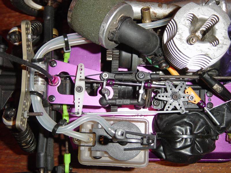

i dont have a pic of it done and the car is assembled... but u see on the pic in front of the brake seat, the diff cup modded cup for the prop shaft...? aye, all i did was superglue the cup on and then grind a flat each side - just to give it a bit more meat for the disc to grab onto.
works a treat with the os18 and a high torque servo behind it... so far at least...

yeh, thats what I want allright. but i am wanting to run both brakes off one brake seat.

i need the 45t single speed spur to try out - its too low geared as it is. theres not enough room on the chassis to get the engine adjusted to go larger than a 18t pinion... maybe foam tyres instead of slicks will help, but its a bit lively to say the least and needs setting up properly to be fair.
havent tried it offroad - scared of losing the spur... but i reckon it might be happier on some short grass with some spiked tyres on, more traction and all that.
the brakes are amazing tho! also turns in very sharp and oversteers out, just so hard balancing the throttle on the shortish gearing/lightweight/silly power. i could do with some smooth ashphalt to try it out for onroad, but well, its supposed to be a rally after all, ill stick to that rather than go for a full onroad setup.
basically its cut out a lot of the understeer from a stock 4wd rally and brakes are better... easier just to go rwd and use a high torque brake/throttle servo on a lighter setup isnt it? [X(]

oh - sorry man... how about removing the tabs completely and just using the flat edge of the disc? hpi and ofna get away with it... if u get a good fit, u might too.
