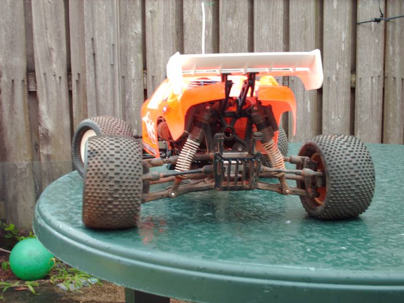

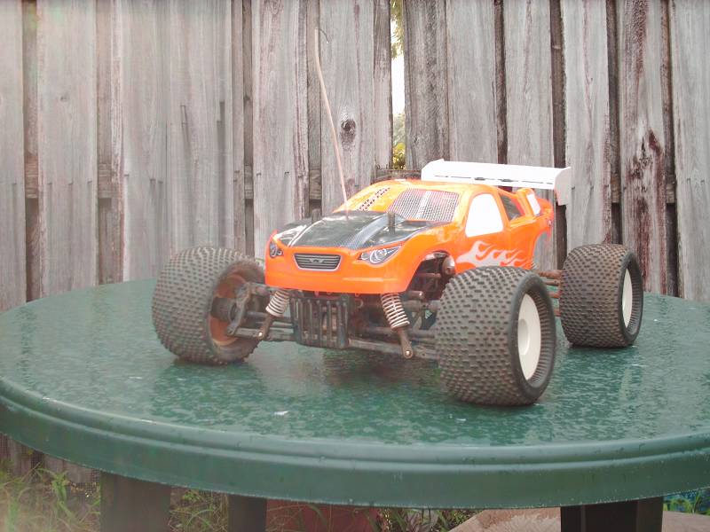

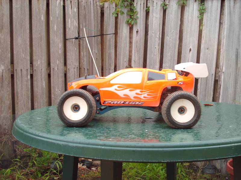

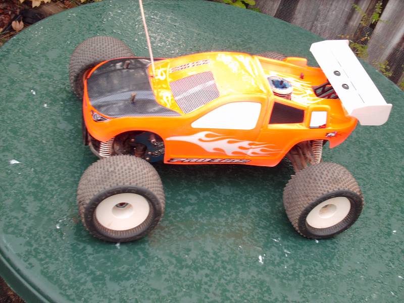

here she is i still need to ream some holes in the side windows let me know what you think

That thing looks MEAN!! I notice you are only running four shocks. What weight oil are you using? Are they CEN shocks? Are you racing or bashing? (sorry for all the questions!!)

4 cen shocks 50 weight in front 40 weight in rear my next project for the is to get the telescoping plastic driveshafts to reduce more weight. im racing it

Looking good...Is that the Matrix wing assembly? If so or not which is it and how did it mount up? Thanks, that is a good looking racer.

its the matrix wing mount assembley and a proline wing it mounted good but you only use the 2 lower screws on the wing mount i still need to run it. only installed it today still need the wing cross bars at the back of the wing. you know those 2 bars that are usually on all the buggy wings. i would say my truck weighs around 14 pounds know just guessing with the plastic driveline from the genesis should place me at the 12 pound mark

Nice what wheels are they and are they still 23mm hexes?

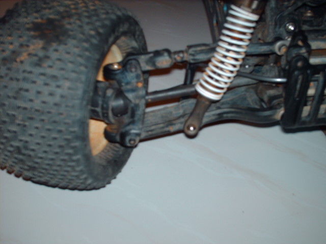

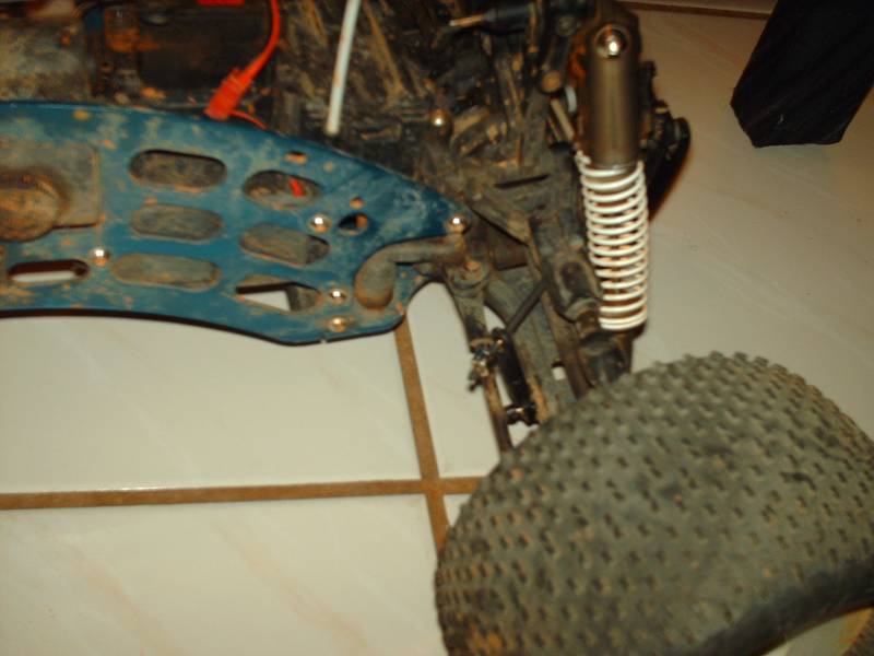

there proline 1/2 offset 23mm rims with bowties i now also have front and rear sway bars on the truck as well.

Where did you get the sway bars from???

Yeah blackrain, where did you get those swaybars from????????

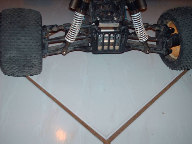

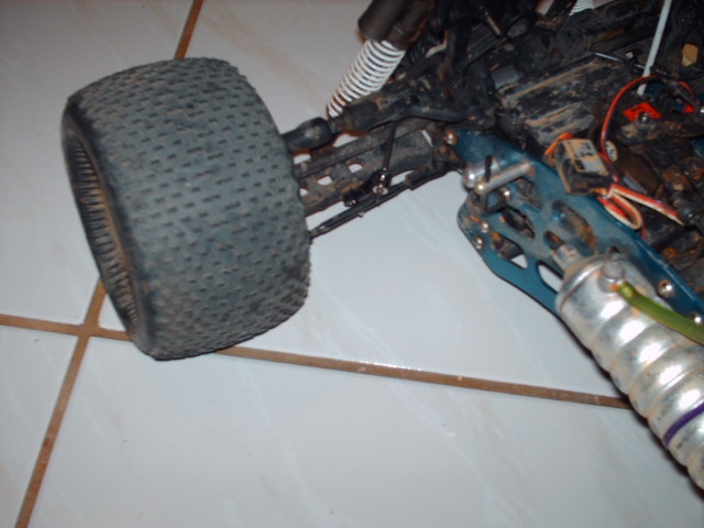

i made them with piano wire they work real well there between 3 and 4 mm dogman thanks for the tip on that one
