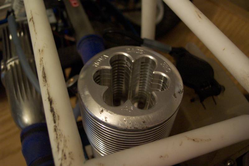

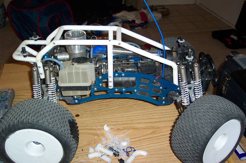

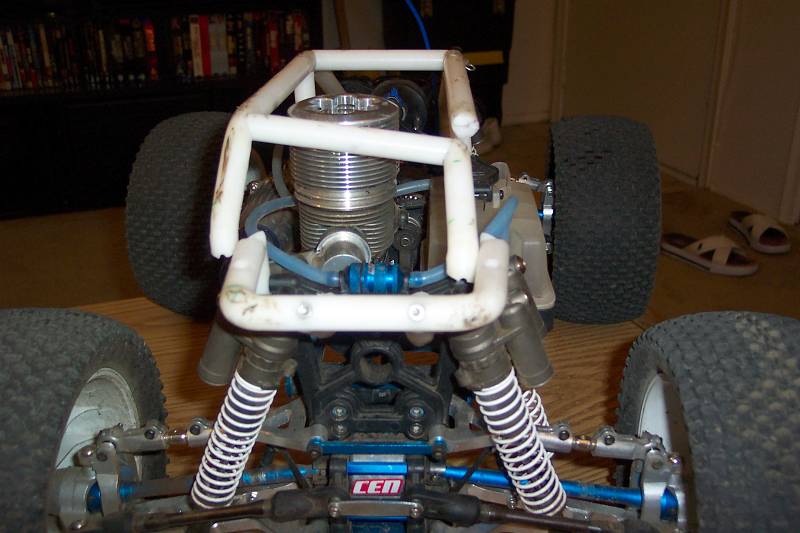

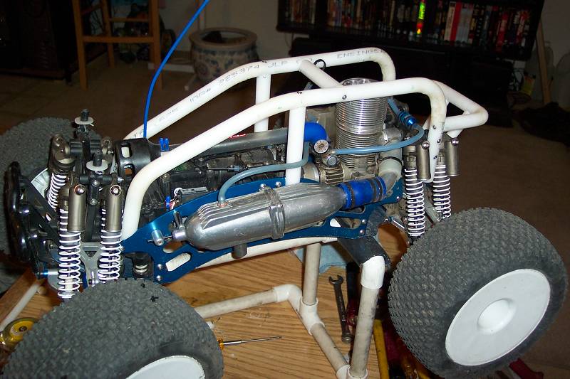

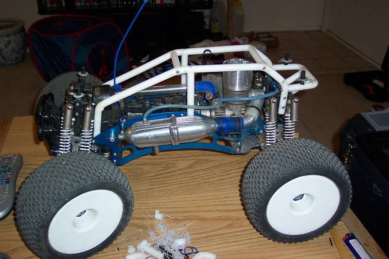

Hey fellas,
Work has been killing my extra time lately, but this week I had an idea.. so I Thought about it, I built it, now, its time to test it..
While testing I tought you guys might want to see it!!

A back scratcher and a remote control .. LOL [sm=thumbs_up.gif] nice job

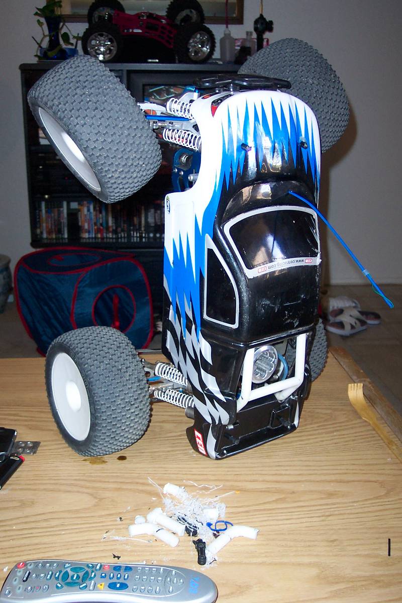

The body even fits perfectly.....

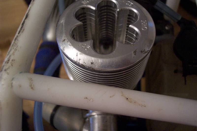

The material is 1/2" Delrin rod...tuff stuff..So I wanted beef up the drag bar abit..to keep this from happening to me..

Well,,yesterday I bashed the living he!! out of the cage..found a jump into an asphalt parking lot that would give the bad*****ed nemi about 12' for about 35' out. Landings were very easy to control,sssooo. after several roof landings, hard tail landings and subsequent bounces,, even few roof skids and general roll-over skids,, this thing hellishly fun!!!never before even thought of launching twelve feet on to asphalt!!! what a BLAST!!
Anyway, I decided, WEEE lets do it again today!!!![8D]
but.....the Cage had other thoughts....Ouch!! did someone say "buttpucker"???

back to the drawing board..gonna build a new one but with some different screws in different locations

ok got a brand new 10' stick 5/8" Delrin acetel rod..Will build it this weekend and I will use different screws and locations as well as not quite so sharp of bends to help dissapate the "shock load" more gradually..

Alrighty then.....It's now 11:38PM sunday night almost monday morning!!!I decided To get stared on this version @ 3:00PM today........Got 'er done And I am pleased with how much stronger this cage seems with the 5/8" Delrin Acetel rod instead of the 1/2"(What was I thinking!!!)
Now, for the cool stuff!!!Tell me whatcha think....

mrarc2002, Bending the delrin is easy,, you actually heat it slowly with a propane torch or industrial heat gun or Iron. I have found that the propane torch it easier and more controllable. Be very careful with the torch it will give off very poisoinous gases and will ignite. You will also want to heat it slowly and let it cool slowly. If you cool it too fast you can actually aneal it(Make it brittle-not stronger). I usually hold it about it 2"(50MM)from the the tip of the flame, and rotate the rod to evenly heat it. I watch the plastic for transparency and it becomes more translucent it will become plyable. You dont want heat too much, so you dont want the plastic to become completly transparent as it will actually "flow" and drip, thus ruining your work. You will have to experiment to get the technique right.
I did alittle light bashing today(had to retune HSN and LSN) to my delight so far this version is alot stronger. But A Good Beating Will Tell The Story.
